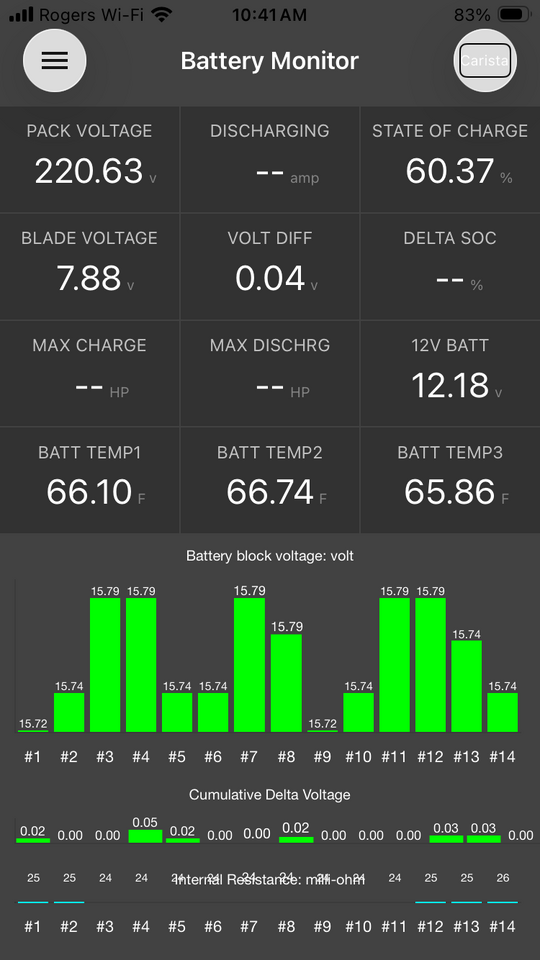

    @Leadfoot J. McCoalroller voices a similar sentiment. FWIW, our '10's got around 67k miles (~107k kms), and I haven't noticed any degradation in the battery.
    tested just now:

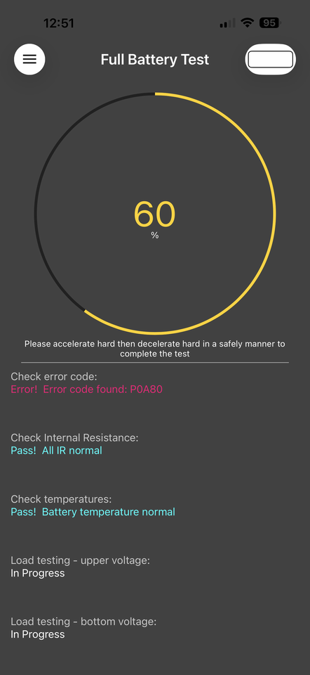

    Depends how it is used. If its used several times a week it will be cycled properly. If someone goes more than one week at a time without using it on a regular basis then that can cause degradation.
    Dr Prius battery snapshots are a poor indicator and only get slightly better when using the paid version. You then attempt to measure how quickly it discharges under load, the theoretical definition of battery capacity.
    Even then its a crap shoot from an engineering viewpoint. I doubt sellers would go along with the forced charge required or the driving needed.
    From a buyer's standpoint, having a scanner capable of reading all ecus for current and permanent codes makes sense. Dr Prius lacks in that department.

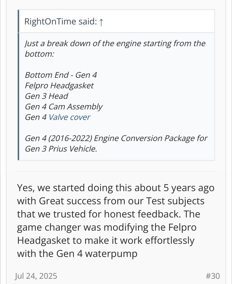

    Is this why some Prii enthusiasts put Generation 4 engines in their Generation 3 Prii?
  16. Viviparous
    Viviparous Junior Member
    May 30, 2026
    31
    Back in California
    2014 Prius v wagon
    Just for clarification: Does this mean that even the 2016-2017 Prius v wagons still have the gen3 engine and its problems except for the new piston rings and pistons, while the 2016-2017 non-wagon (non-v) Prii do not have these problems because they have gen4 engines with improved pistons/EGR/water pump, etc.?

    There were incremental improvements in gen3 engines along the way. If you compared a 2011 gen3 to a 2017 gen3 there were improvements to pistons, rings, intake manifold, egr valve, ecu software and head gasket.
    The gen4 engine has proven to be more resistant to head gasket problems and mechanically can replace a gen3 engine with some piping and wiring modifications. Most agree it is an easier swap using a gen3 head, intake and egr on a gen4 block which keeps piping and wiring changes to a minimum.
