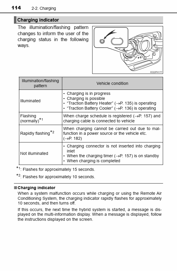

  13. EdPalmer42
    EdPalmer42 Member
    Dec 3, 2019
    135
    75
    2020 Prius Prime
    Check out the attached page. It talks about TWO different flashing patterns. One is okay, the other is bad.
    Actually, if you don't have a hard copy of the manual, you should try for a pdf copy. Mine has some more involved troubleshooting steps but they might not be same for my 2020 as for your 2017.
    Other than this, I'm out of ideas.
  14. Gianni I
    Gianni I Member
    Dec 22, 2017
    72
    40
    Long Island
    That is helpful thanks. The rapid flashing is what I get exactly. I downloaded my 2017 manual and there is no section like the one you have in yours. I looked around elsewhere on the 2020 manual and every troubleshoot thing says to "Stop charging and contact Toyota Dealer" lol
