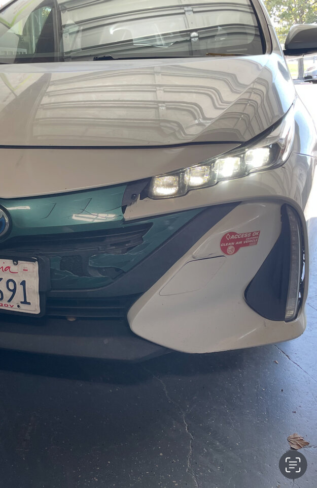

    I was wondering is the gen3 prius cat and 2017 prius prime the same? Im asking because the heat exchanger is broken and im leaking coolant out of the exhaust and my friend have a gen3 cat.
    another question do i have to buy the whole center piece or i can just buy the green over lay?

    The CATs are different and a totally different heat exchanger setup.
    I believe the grill is a one piece unit from Toyota. You can try to find a used one and separate the front from the rear backing. You'll have to remove the whole front bumper assembly anyways - so snapping in the Toyota unit will speed up the process.
