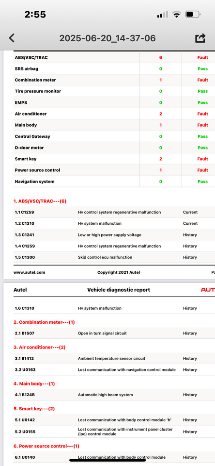

    Ok put a new current sensor A in and it did nothing. Now it won't even start. Ran diagnostics and got the following report.

    OK I've done some reading on the 2 current error codes. Both are VERY expensive to have fixed and they tell me to check see if the ABS is working ETC .... Not a clue how to proceed and all the. videos that I have found so far are for older vehicles. Mine is 2018

    What Autel scanner are you using?
    The two current codes C1259 and C1310 mean that you have at least one trouble code reported by the hybrid control ECU. The Autel scanner that you are using is not showing that it has communicated with the hybrid control ECU. So you are not able to read the trouble code.
    It looks like the scanner you are using is only communicating with 12 different ECUs (systems) in your car. I do not know how many systems are in a 2018 Prius c, but my 2011 Gen 3 Prius has 21 systems.
