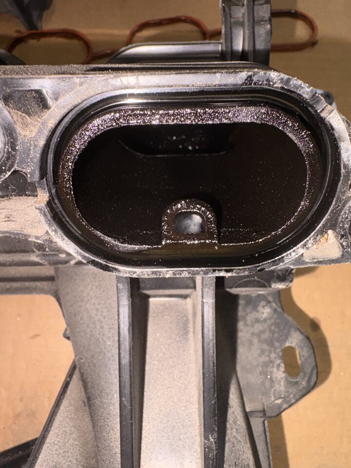

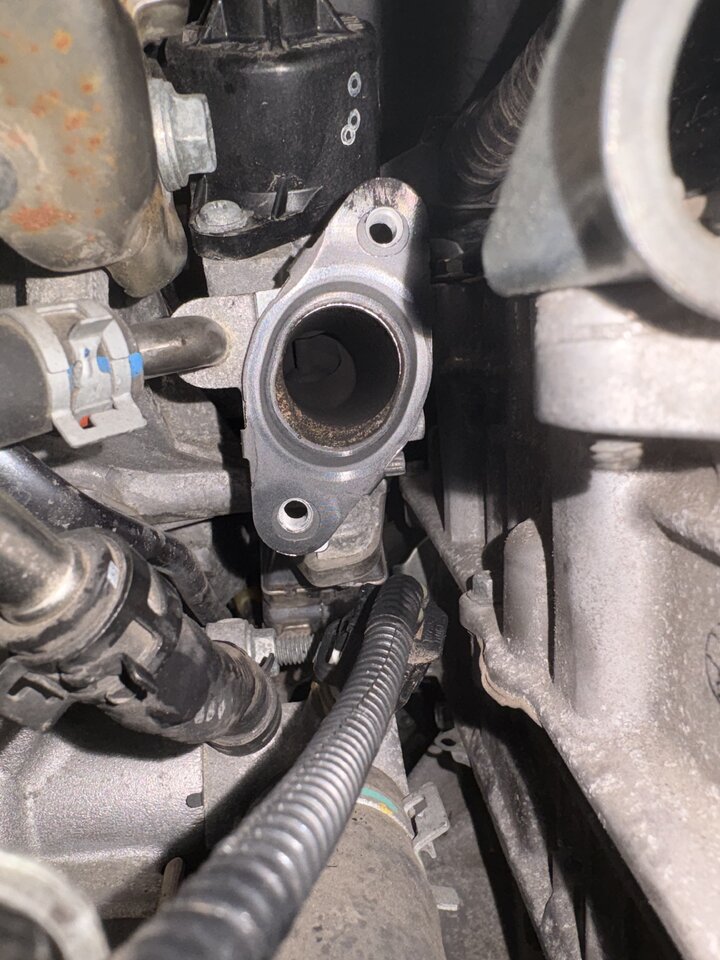

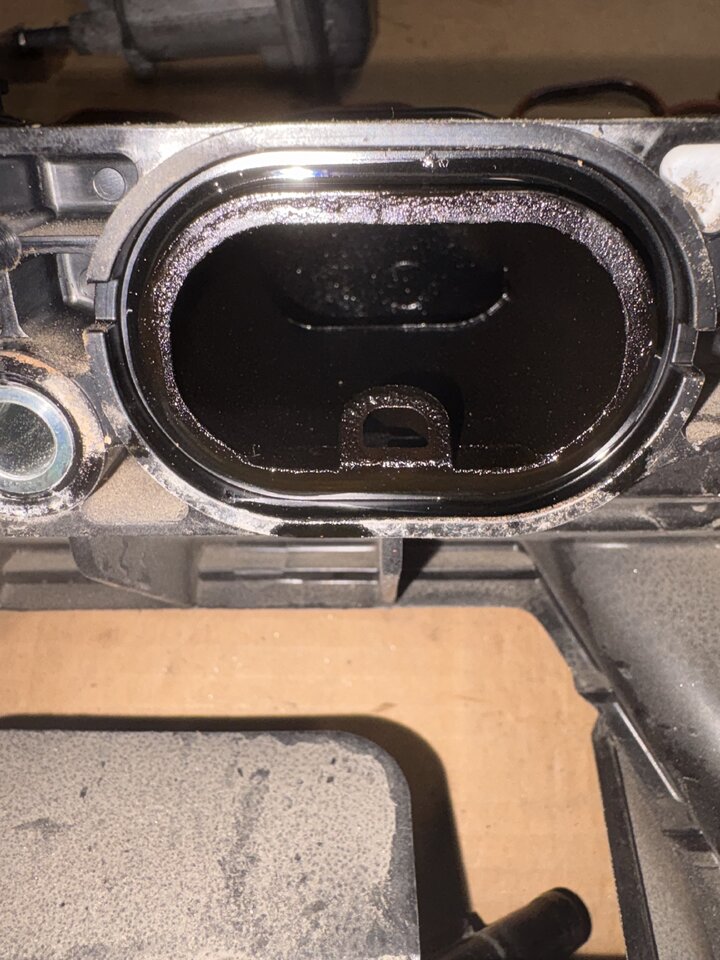

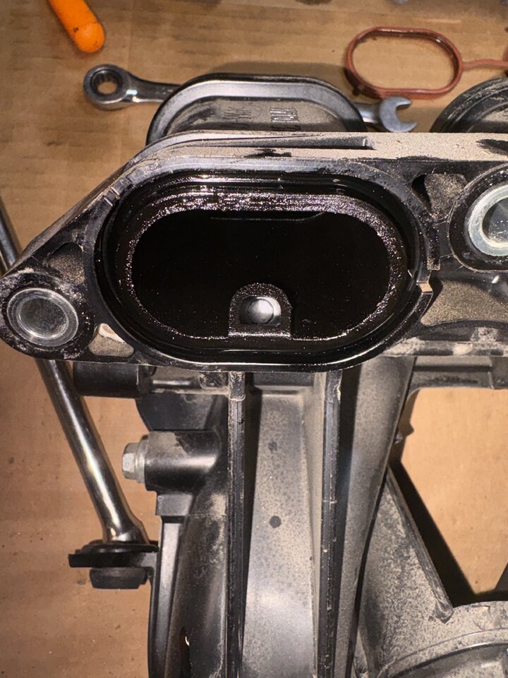

    @ChapmanF Took the intake out, the four EGR ports are very clean. I will still clean them but I’m not sure these are the problem though I was hoping they were.
    I took the actuator off and the EGR valve moves easily and springs back to closed no problem.
    EGR pipe sooty and dry

    I can verify this as well at 80k miles the valves are still shiny, throttle body clean and almost no carbon at all in the intake passages. Im kicking myself for pulling it apart now especially since its running poorly. I wish i just did new spark plugs as a good measure, but at least we can rule out the clogged ports haha

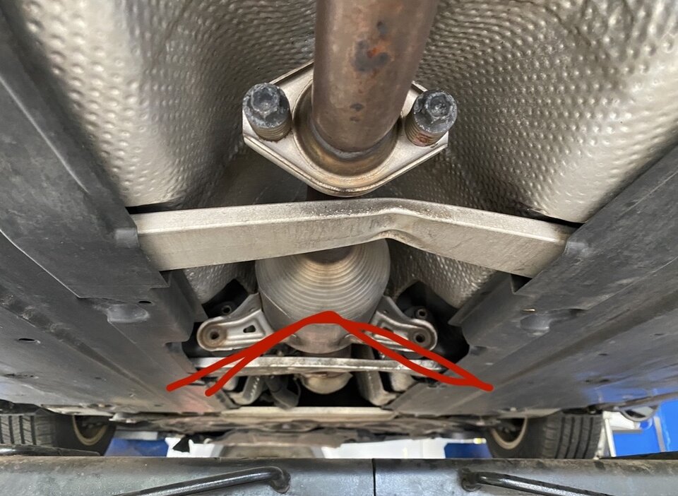

    Had the car put on a lift and both of these aluminum cross braces were bent and smashed up into the exhaust, the front one was really bad so he fixed it but the rear one he just left like that.
    he thinks the car went off a jump or something haha
    lower motor mount is torn as well
    Mechanic straightened brackets and the vibration went away.
    now for alignment and new motor mount
    solved
