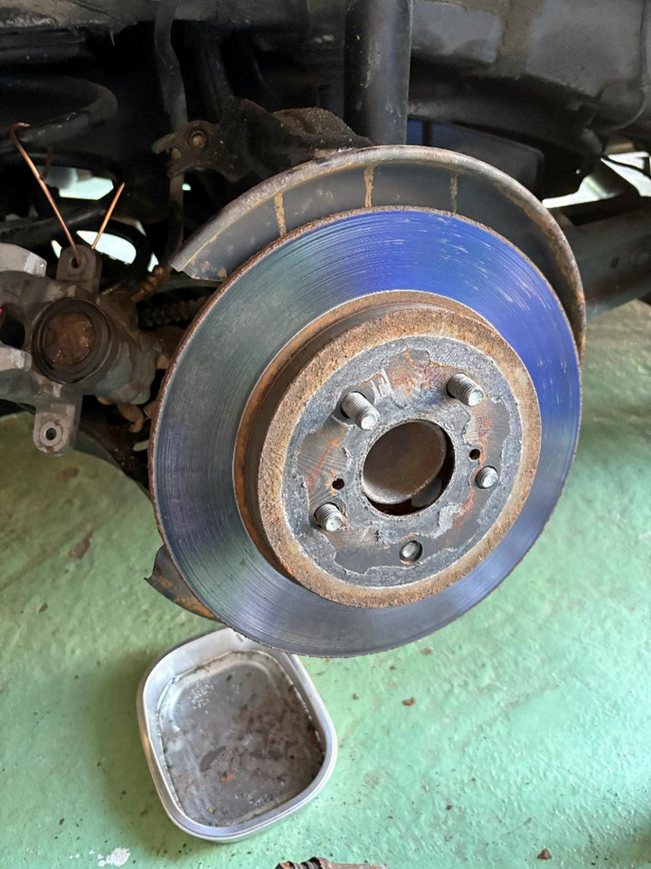

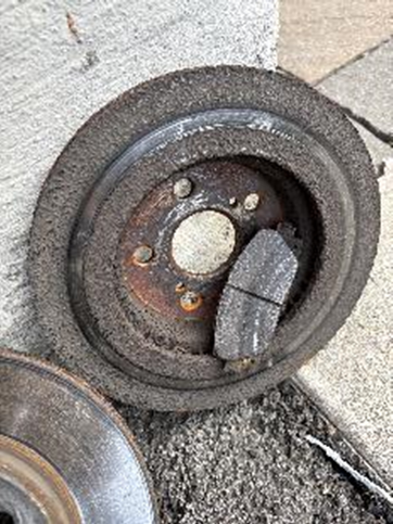

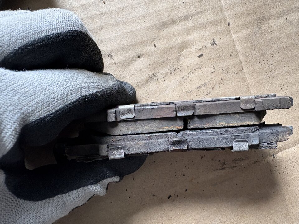

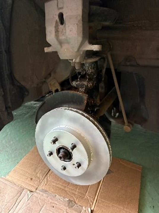

    I just changed brakes on all four corners.
    I usually replace brake pads when it is worn to the slot in the friction material. Didn't measure how many mm of material is remaining. IMG_5042.JPG
    The rotors are very corroded on the inboard side. upload_2025-5-15_14-51-27.png
    I ordered the parts from RockAuto and paid just over $300 CDN, where about $75 was shipping.
    Cleaned and lubed all the slide pins with silicone paste.
    Rear calipers are simple. I used needle nose pliers to fit in the piston and turned them while pressing in. (I saw a video where a angle grinder wrench was used.)
    Caliper bolts were 25 ft lbs. that attach to the slide pins.
    Torque plate (bracket that holds the slide pins bolted to the hub is 75 ft lb for the front and 42 ft lb in the rear.

    To insert the front brake caliper pistons, is it the same as the rear ones?
