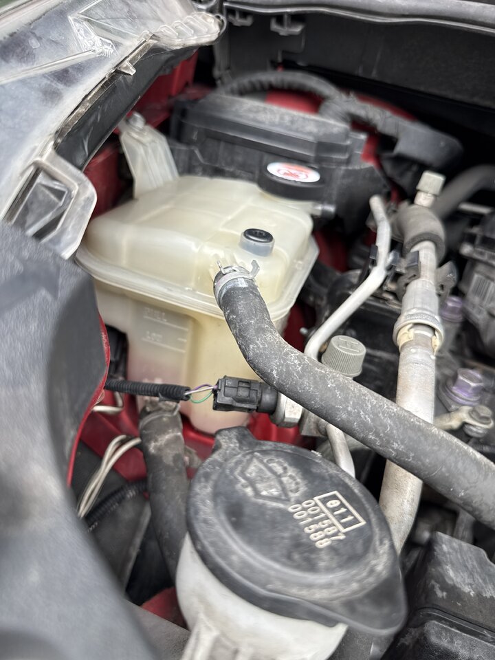

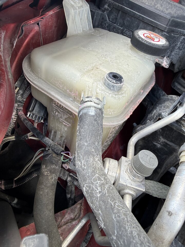

    A couple years ago my Prius was leaking coolant. I took it to the dealership and paid them for diagnostics and they said I needed a $1500 Catalytic Converter. My buddy said that was a known issue and he did the bypass for me. A couple months ago my coolant started leaking again. I found out about the TSB from September 2019 (T-SB-0135-19) on the NHTSA government website about the coolant leak issue and called Toyota Corporate and complained and managed to get them to replace the pipe under warranty even though it was over the mileage for the warranty. I thought that would fix the issue but later on that day the coolant reservoir was empty. I put some coolant in and took it in the next morning. The looked it over and said everything was fine and there was probably air in the line. However, after I left I had to put coolant in around every 4-5 days. I took it back and they did a pressure test and they said it passed. They tried swapping the caps between the two different coolant reservoirs. It was fine for about a week then I had to put coolant in again. I ordered a new coolant cap just to try it to see if it might help and they said it would be here tomorrow. I had them change the spark plugs when they had it the other day for the coolant pressure test and they sent me a photo of them. It did look like one of them was a lot whiter than the others but I mentioned it and they didn’t seem concerned. One suggestion I saw online was to get an inexpensive block tester kit (chemical fluid test) to check the coolant reservoir for the presence of exhaust gases. I haven’t tried that yet. I’m not getting any check engine codes or smoke coming out of the exhaust. They said since they replaced the entire heat exchanger pipe with the new part in the TSB that probably isn’t the issue. Since there aren’t any check engine codes I could probably just keep running it and checking the coolant to make sure it isn’t low but I’d rather find the problem and solve it if possible. I did notice when I use the funnel to pour in coolant it seems to leak out the top a little bit by the plastic piece that sticks out with the little black end on it. I think that’s the overflow but I’m not sure. I might not be using the correct funnel.
    Does anyone have any ideas on what else to check?

    is that dried coolant all over everything?

    It spilled when I was trying to pour it in with the funnel. I need to try to rinse it off.

    It looks like dried coolant all over the plastic reservoir. To troubleshoot, you need to monitor the engine coolant temperature. Watching the coolant temperature will tell you if the coolant is getting hotter than it should be.
    My theory is the engine water pump is going bad. The pump is not pumping enough coolant through the engine to keep it cool. The coolant heats up too much and creates enough pressure in the system that some coolant is released past the reservoir cap and out that little overflow nipple. This is common behavior for the Gen 3 Prius when the pump is going bad. I have not seen many reports for the Gen 4. Try putting a rag around the reservoir overflow to see if that is where the coolant is being released from.

    ^ Yep; coolant splash in that area would indicate that it's boiling out. Kinda obvious to any experienced mechanic. Assuming the dealership did the pressure test correctly, (that's a BIG if) - since he should've noticed that "right off" - it's probably the electric ENGINE water pump not spinning fast enough to keep the coolant from boiling out - but fast enough not to trip the temp lamp at 248+F. Swapping coolant reservoir caps? They should've been inspected and a missing sealing ring would cause leaks and not allow the system to properly pressurize.
    You can still have a head gasket issue; if that leak test was performed with the engine warm or hot. The aluminum would expand and seal the leak - that's why we say to pay attention to early cold morning startup misfires that disappears after a few minutes.

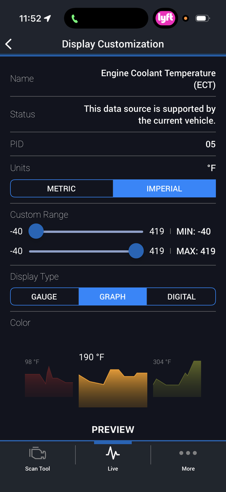

    I found an option to monitor the coolant temperature using my Blue Driver OBD II port adapter. What temperature ranges should I be looking for to determine if it is an issue with the water pump? I”m sitting here at the airport and it is currently at 178 degrees Fahrenheit.

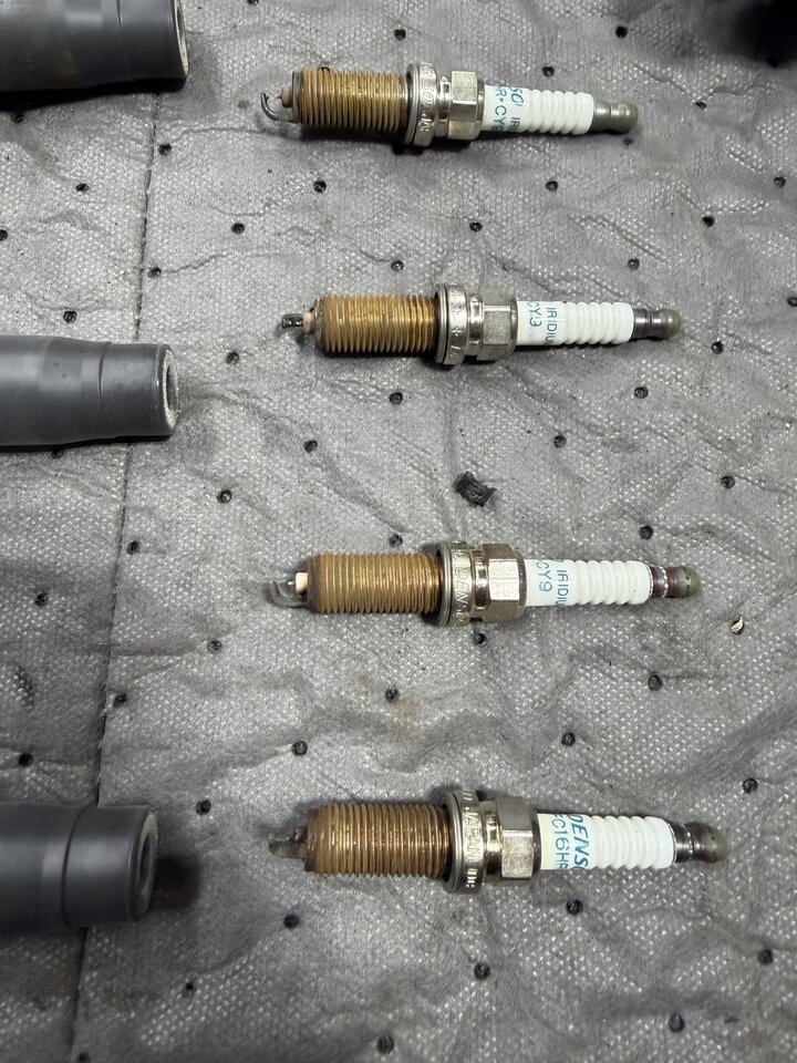

    it is interesting how polished the third spark plug is. maybe a borescope of the piston top to see if it's scrubbed

    around 180F-195F nominal. you may touch upon 200F while crossing over steep mountain ranges.

    Cruising on the highway should be about 195F. Going up hills on highway usually will not go above 202F. Just drive the car and keep an eye on the temperature.

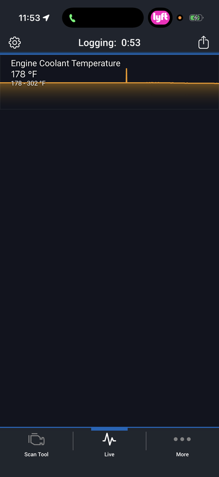

    Today I got a smaller funnel so the coolant wouldn’t spill when I put it in, I cleaned off the old coolant from the outside of the reservoir, and put the new coolant cap on. I’ll easily be able to tell if coolant is escaping from there now. The dried coolant in the pics was from the coolant I spilled when pouring it in because I had the wrong funnel.
    So far I don’t think the temp has gone above 200 so I doubt it is overheating but I’ve only checked it randomly throughout the day.

    I don’t even have the spark plugs because the dealership changed them and I don’t know much about doing a borescope of the piston top. I asked them to send me the pic of the spark plugs because I didn’t think they had been changed in a really long time, if at all, and I wanted to see what they looked like to see if one of them was really clean or anything like that. Judging by the picture they sent me I was wondering if the coolant leaking in and cleaning the one spark plug.

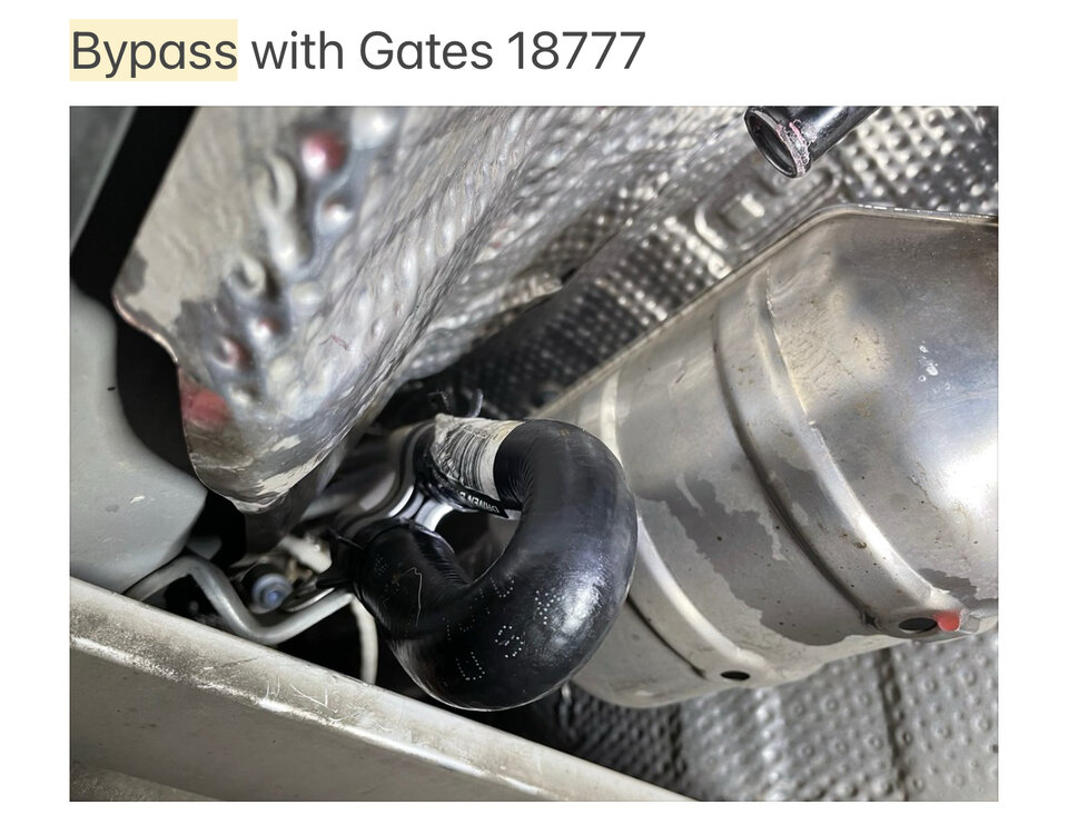

    1. Exhaust heat exchanger again. A bypass hose is less than $10.
