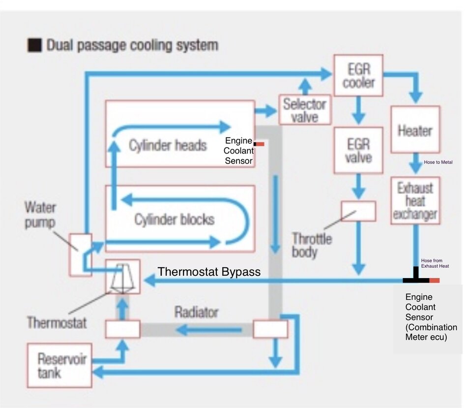

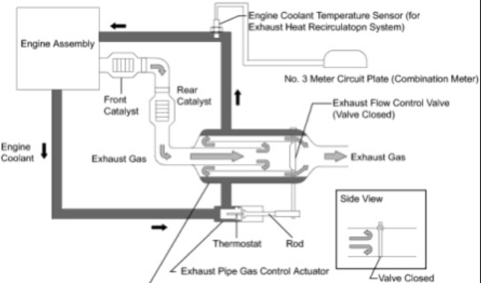

    It passed the borescope test. No obvious leaks. It points at the exhaust heat exchanger again. I would bypass it. Again. If a bypass fixed it I would leave it bypassed and force the exhaust heat mechanical thermostat into its extended, warmed up state.
    Gen4 Coolant Flow

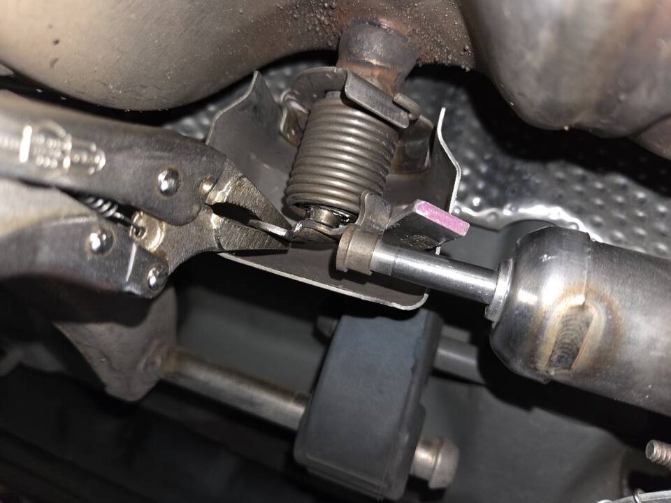

    Exhaust Heat Control Valve Forced Open on a Gen3
    Exhaust Heat Recirc Actuator 2of4JPG.jpeg Exhaust Heat Recirc Actuator 1of4JPG.jpeg
    Finally, a borescope test can provide a false negative if done by an inexperienced person. A exhaust heat bypass that does not solve the issue points right back to the hg.

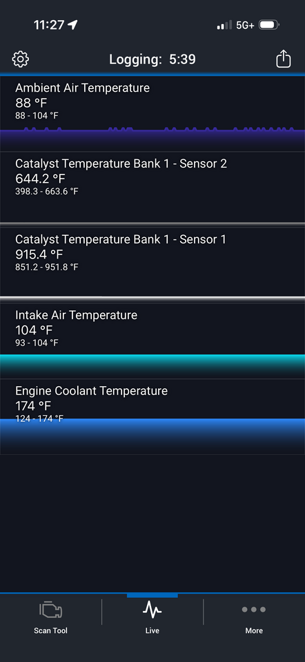

    Thank you. I tried to get it up to operating temperature but there is no gage on the dash so I just did my best. I think I’ll try the bypass again and see what happens. If I can prove it is a bad heat exchanger I should be able to get them to replace it again for free since they just replaced it. The trouble is they keep saying it’s a new part and it is the redesigned on so it is probably fine.

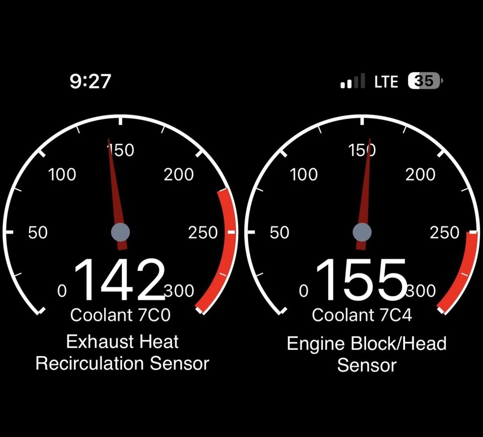

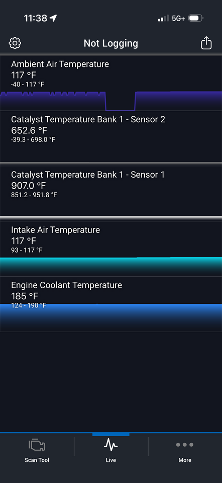

    I would also monitor the coolant temperature in real time as noted before using a simple bluetooth scanner and a phone app or a dedicated obd2 display.

    I did leave it overnight for the pressure test so I hope they did it correctly. I tried using my Blue Driver OBD II app to monitor the temp while I was doing the test. I might get one of those HUDs for the future. IMG_0106.png IMG_0108.png

    You should be monitoring the coolant temperature while driving. That is the only way to rule out an intermediate water pump. I thought you were going to do that.

    Use your app while you are driving to verify the engine stays below 210f with typical engine on temperatures around 195f or less.

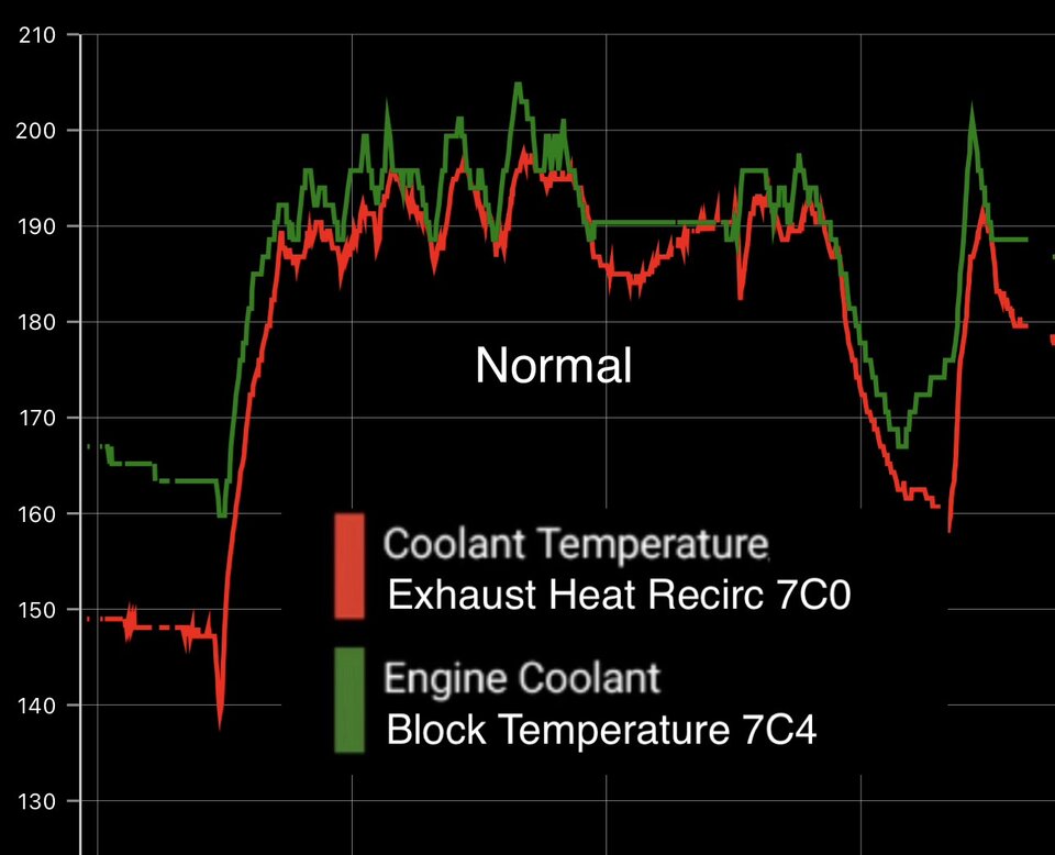

    Also note in post 31 there are two "engine" temperature sensors. My gen3 experience is the engine temperature is a bit higher than the exhaust heat exchanger when the engine coolant is warmed up.
    This "Car Scanner" app trending capture shows full load peaks when driving up a steep grade several times with ac on in the summer.
    Each horizontal axis time period is 8 minutes
    Note how much the engine cooled in the last segment. That period was Ready engine off with the ac on and represents the rapid thermal cycling a Prius can experience. It was followed by one more high load hill ascent.

    Sorry if I already asked this in another post @rjparker - but your picture is a valve forced open- why is that again? Also- not all Gen3's had this did they?

    That is the "exhaust flow control valve" (illustration post 28) that diverts exhaust flow 100% through the heat exchanger. Even with a coolant hose bypass, the mechanical actuator still forces exhaust flow diversion instead of straight through. Forcing it open reduces back pressure after a bypass.
    All gen3s and gen4s have this system. Gen2 did not.
