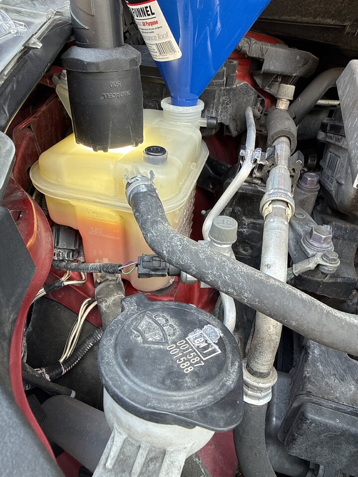

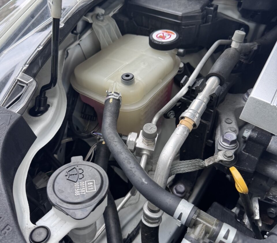

  5. C Clay
    C Clay Member
    Nov 24, 2012
    408
    82
    Lexington, KY
    2019 Prius
    L Eco
    Not intending to highjack thread- but wondering if @JeffPGH notices same thing- when I put coolant in the car in the morning, I hear a gurgling as if the coolant level is going to go down incrementally if I were to give it a minute, but it doesn’t appear to. Why is it that the right corner will appear as if it has no fluid but yet the left corner and the rear right clearly show that there is half way up the volume of the tank it would seem.
