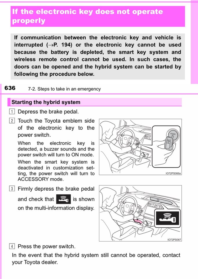

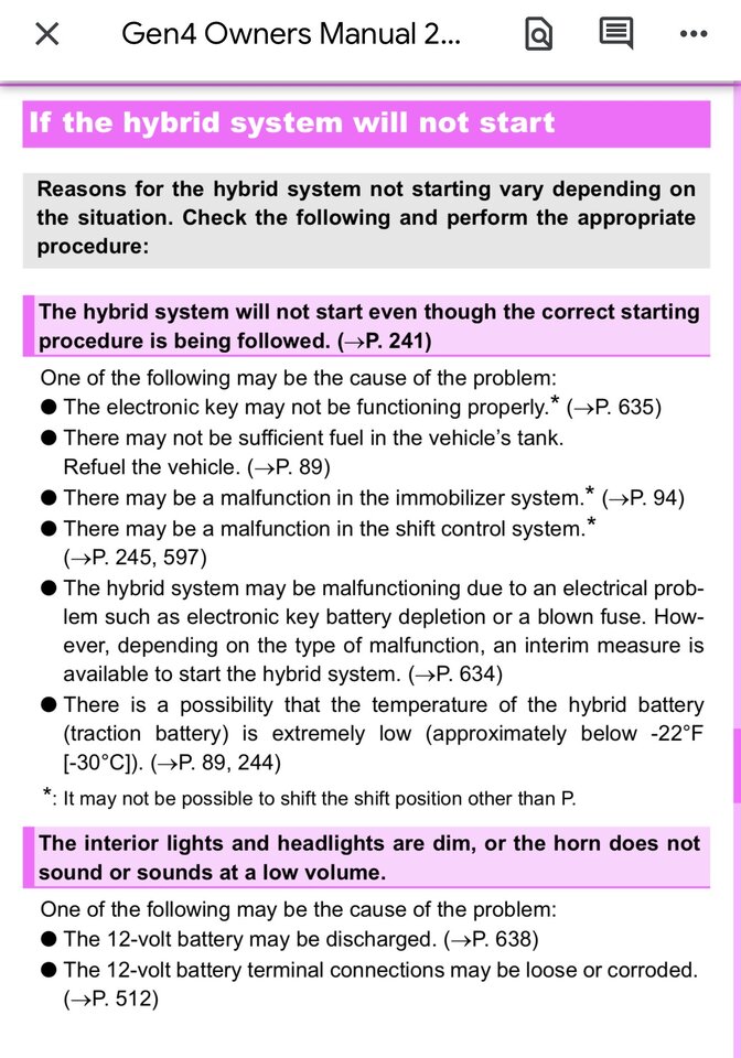

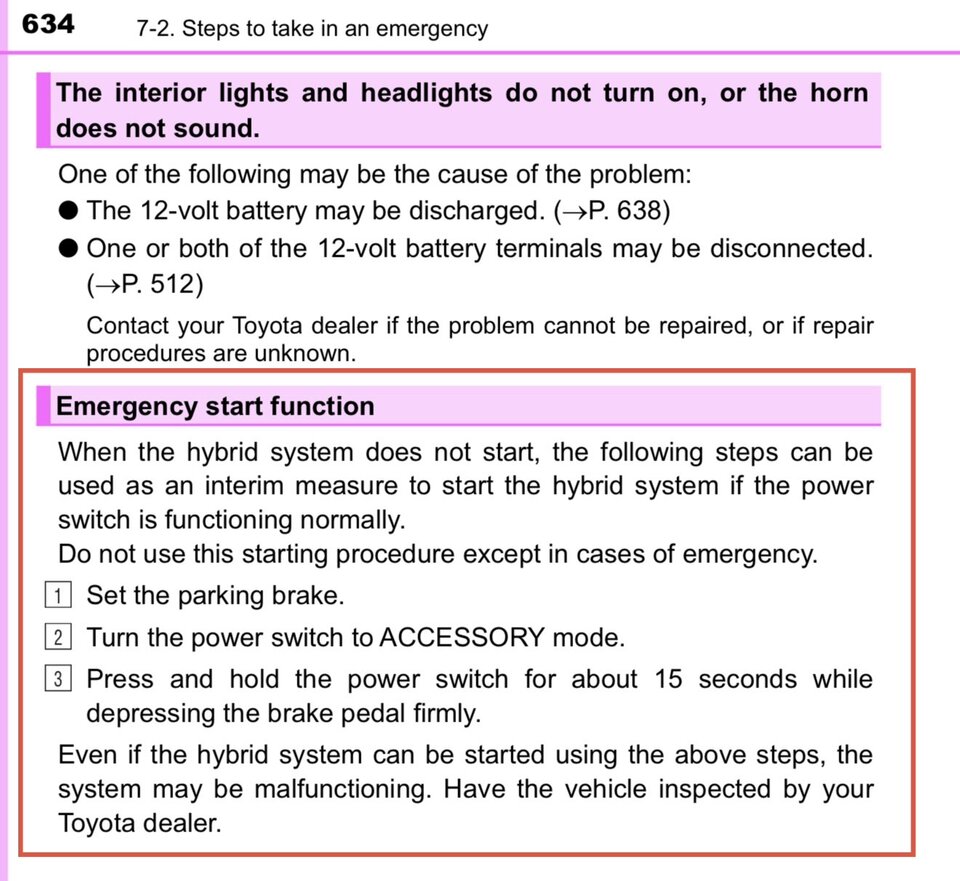

    There are two alternative ways to start the car. If one of these work it points to an issue needing repair by a tech.
    Basics from the book in the glove box
    Alternative Start 1
    Alternative Start 2
    BiomedO1 likes this.

    This is how I was able to get home after being stranded an hour from home. Option 2 did nothing but option 1 got it started. It worked fine for the next week after that and ran fine. Took it to a mechanic anyway but they found nothing other than a brake sensor code on their Toyota scanner device. They replaced the sensor and tried to take it out of the garage and the same issue occurred. Couldn’t find anything else outside the sensor.

    Hey financial hardship happens. I make decent money but had to have surgery that cost ~$80k. Money is tight right now. Key fob was first thing I checked and replaced batteries in. Fob works fine and has given that message before when it got low. No such message now. Simply goes into accessory mode only unless I use the emergency/maintenance start function (parking brake engaged, accessory mode, and then hold start for 15+ seconds)

    It can force start your car in an emergency. I found it while stranded and trying to troubleshoot the issue myself with limited tools. Basically you apply the parking brake, put the car in accessory mode, hold the start button for 15+ seconds.
    That got me home. Next day I went out and the car cranked up and started no issue. I used it for most the next week no issues and figured I should take it anyway to get checked. Dropped it off on a Friday and on Monday they went to move it into the garage and the battery (12v had died despite being maybe a week or two old). He charged it up and got it into the garage where they checked it with a scanner that does Toyotas. Only code to pop up was brake sensor. He replaced it (no charge) and went to pull it out… it did for him what it did to me. Battery (12v) was fully charged but would only go into accessory mode or you could force it to start with the emergency/maintenance mode listed in the manual.
