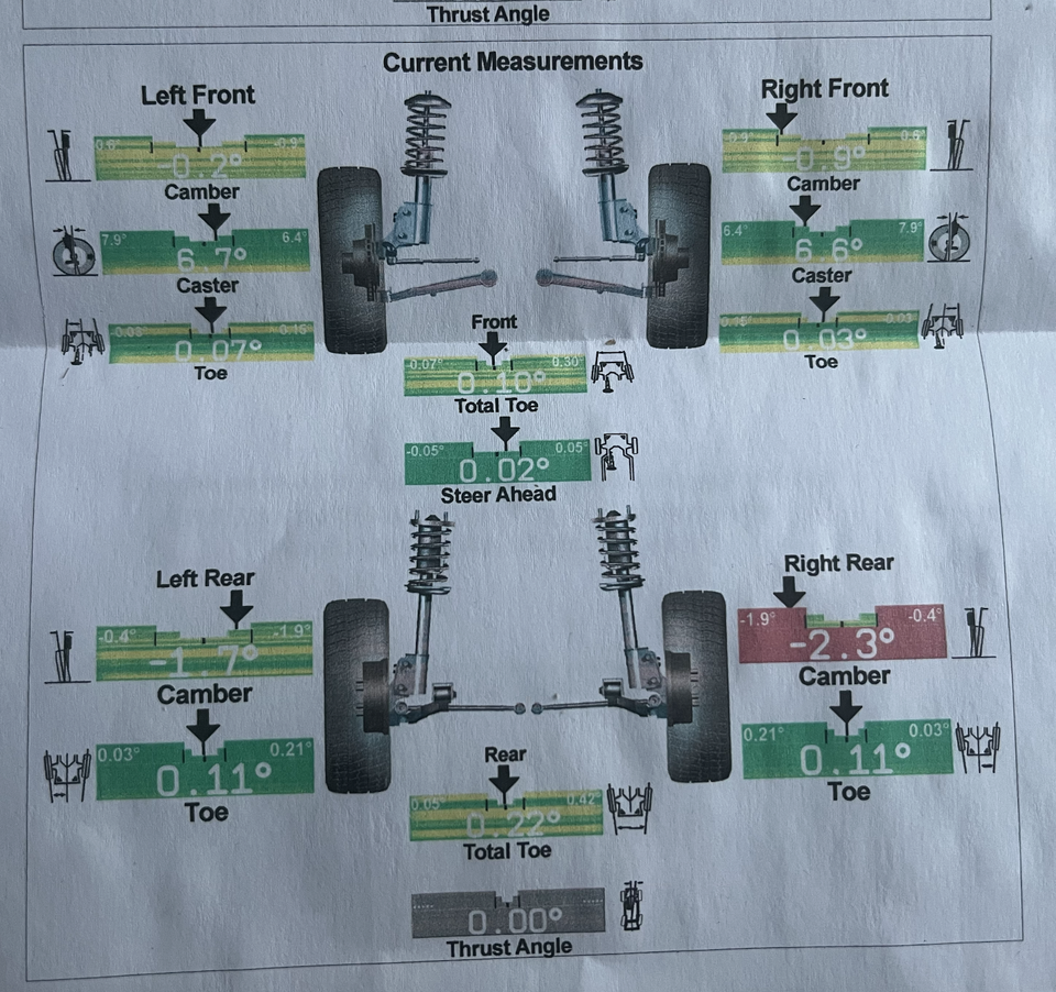

    Hello all,
    Just had an alignment and after everything has been aligned, learning there is a 'camber' issue that falls outside the scope of the alignment and the shop said I had to talk to a store manager when they are back in the shop. They mentioned aftermarket kits. Fair amount of digging online and maybe more confused then when I learned of the need.
    2021 Prime
    I am handy enough around cars, have a torque wrench and such. Is this something easy enough for a first-timer, or not worth the effort and hire a shop to fix?

    Update:
    Shop service manager (non-toyota) is saying there are no specs, and an after-market kit would cost hundreds to purchase and install with zero guarantee and even a new one would not be adjustable, recommending rotating tires slightly more often than normal.
    Seems a bit fishy.

    Thank you @Mendel Leisk (saw that elsewhere and didn't look hard enough in the doc for rear camber.)

    Rear right camber shows -2.3%.
    In addition to saying 'no specs' shop is saying not a big deal, simply rotate tires a little more often...(?)
