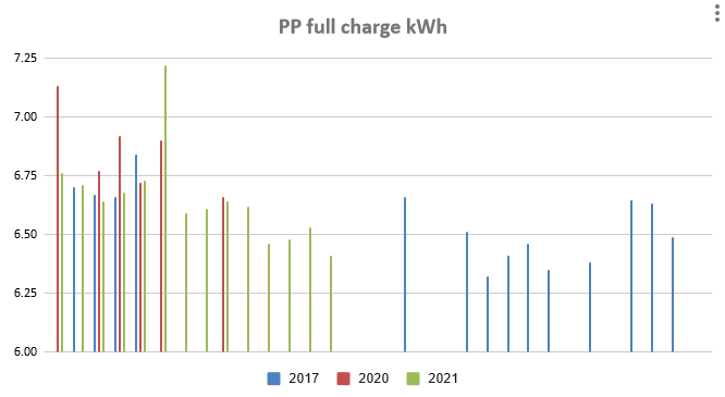

    From my small number of use cases, the practice of charging did not alter the traction battery degradation rate noticeably by changing the routine.
    • For my 2017 PP, I used all traction battery charges on daily bases and charged it fully at night using the battery charge schedule for ~3 years.
    • For my 2020 PP, the car was almost never charged full, and mostly sat on the driveway with 30-40% charge left on the traction battery, and when being charged, it was charged only to ~50% unless I planned to use it up the next day. I did this ~10 mo.
    • For my current 21 PP, I charge whenever convenient either when the traction battery is empty or partial charge remained, and charge it to full most of the time even if the car is not going to be used for a few days. I have done this for 15 mo now.
    In all three use cases, the traction battery rate of degradation was similar during the first year of usage, which was at about a 5% loss of capacity in all three use cases.
    I reported my data in the linked thread below. See the graph for a comparison of three different PPs having received different charging routines.

    While I see points made by many for the best practice to prolong the longevity of the traction battery, my own experience and data point to the indifference for the rate of traction battery degradation for the short term (less than three years) regardless of the way the traction battery is charged.
    There may be some statistically significant differences in the rate of degradation if compared for a long term say for 10 years. But I am not going to be overly concerned about how I charge the traction battery on my PP. Yeah, I am not going to charge it up to 100% and store it under the hot sun for months at a time. But for my current normal usage of several unscheduled trips per week, mostly 15-30 miles EV range trips, I just plug the car when it is convenient, so the car has a full charge when I need to use it. If it sit for a few days with 100% SOC on the dash, I am not going to panic. My data clearly shows at least for the first year, the rate of degradation is very similar to my previous PP which was almost never charged to full but sat mostly at 30-40% SOC.
    Here is the graph of similar data taken from my other two PPs. 2017 PP was kept for 30 months, and 2020 PP was kept for only 10 months. The 2020 PP (Red bars) shows a very similar rate for the decreasing kWh for a full charge for the first 10 months as the 2021 PP (Green bars). Unfortunately, I did not keep the record for the 2017 PP (Blue bars) between months 5-16. But after 24 months, the 2017 PP full charge kWh number is similar to 12 mo old 2021 PP data.
