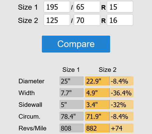

    FWIW: there's a two inch diameter differential from OEM, which may set off your traction control. You'll definitely set off your TPMS. You may have to turn-off traction control with this tire mounted. You may want to put a note with your tire change tools to remind you.
    Tire Size Comparison
    #5 BiomedO1, Jun 25, 2025

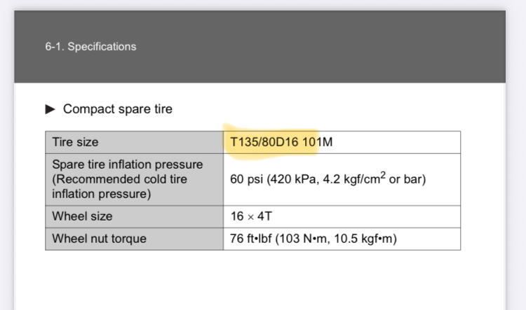

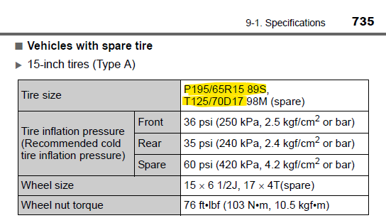

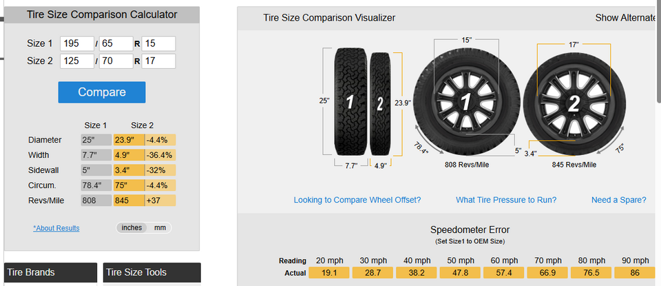

    You're saying between the stock 15" tire, and the temp spare? From Owner's Manual:
    Plugging the two sizes in at Tire Size Comparison site, it's 1.1" diff, on diameter, or .55" diff on radius.
    Plus, the temp spare size is spec'd by Toyota; I think they would have checked if the diff is enough to set off traction control.
    FWIW, Gen 3 has the same stock tire size, but the temp spare is 16", with OD virtually the same as stock. Not sure why they would revise for 4th gen.

    I went by the numbers he published. Two inch differential - he may have published the wrong size.

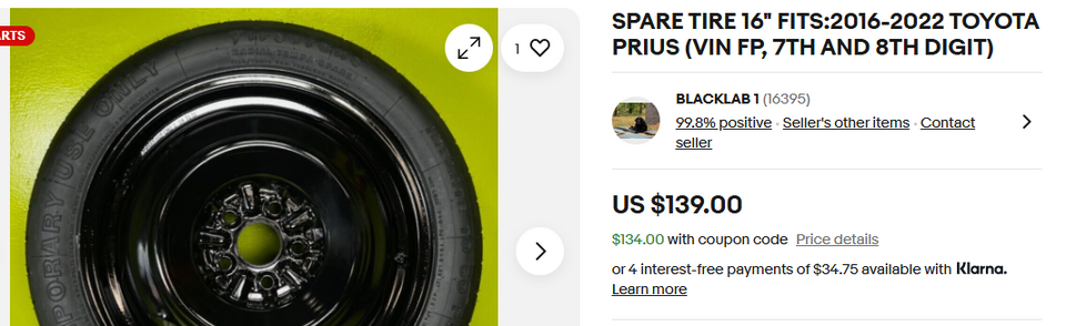

    Well, I guess that's a no on that auction as the tire they are selling is a 125/70r16.

    Maybe the “16” is a typo? Can you contact seller?

    incidentally: the aforementioned third gen temp spare is also compatible, and its od quite close. Except used ones for sale could be 15+ years old. Size is:
    T135/80D16 101M

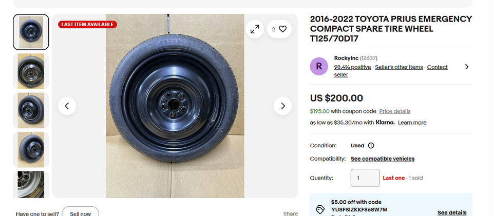

    Sadly this is the best deal I can find on ebay.

    Gen 3 and 4 stock size is 195/65R15, but Gen 2 is 185/65R15.
    Gen 3 and 4 temp spare sizes vary (inexplicably), gen 3 being closer in outside diameter to stock size.
