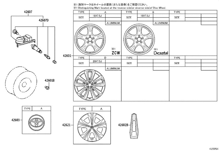

    Your photo for the Crown is broken. So far, the best piece of evidence that supports the idea that Crown (SH35) and Lexus IS and NX use wheel bolts not lug nuts is on this page. I don't know for sure, but I get a feeling that Kyoei is the OEM of lug nuts and bolts for many Japanese cars including Toyota, but they may only make aftermarket bolts and nuts. For reference, the table on the linked page does not have Gen5 Prius nor any previous models of Prius.
    ホイールナット&ボルトについて
