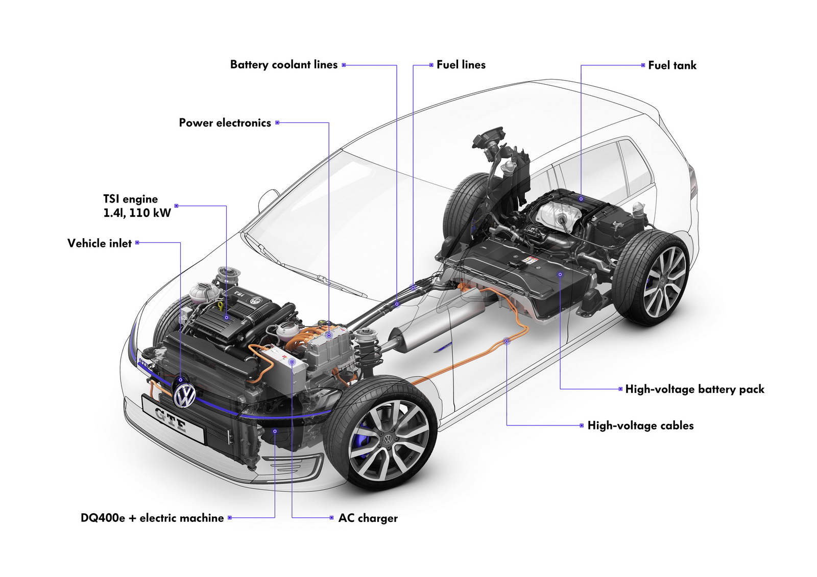

    There are different ways to package the rear end of a PHEV with a control blade IRS, that could be significantly better than the existing Prius PHV/Prime (also worth noting that this car predates the Gen 4 Prius):
    A fuel tank can also package a lot more flexibly around components in the rear of the car than a battery can, because molding it to a more complex shape is a lot easier than laying out battery cells in an oddly-shaped pack to fill available spaces. (This is also why the spare tire well is just empty in the Gen 4 PHV/Prime - it would cost too much to lower part of the pack into it.)
    (The pictured layout of the Mk6 Golf GTE also makes it easier to watercool the battery than a layout like the Gen 4 Prime's, which is beneficial for battery longevity and performance, and allows much denser battery packaging than an aircooled battery. The Mk6 Golf GTE does have a similarly sized battery in kWh to the Gen 4 Prime, but as the Prius is a much larger vehicle than the Mk6 Golf (and the rumored Gen 5 Prius dimensions are close to the Passat GTE's wheelbase), there's room to have more battery.)

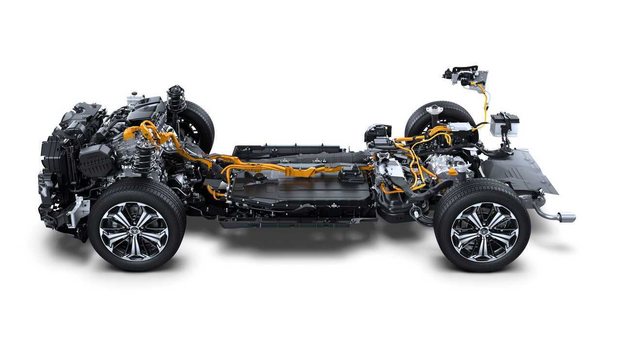

    Toyota's not gone for that packaging though, AFAIK - the closest they've come is putting the battery under the passenger compartment as in the RAV4 Prime:
