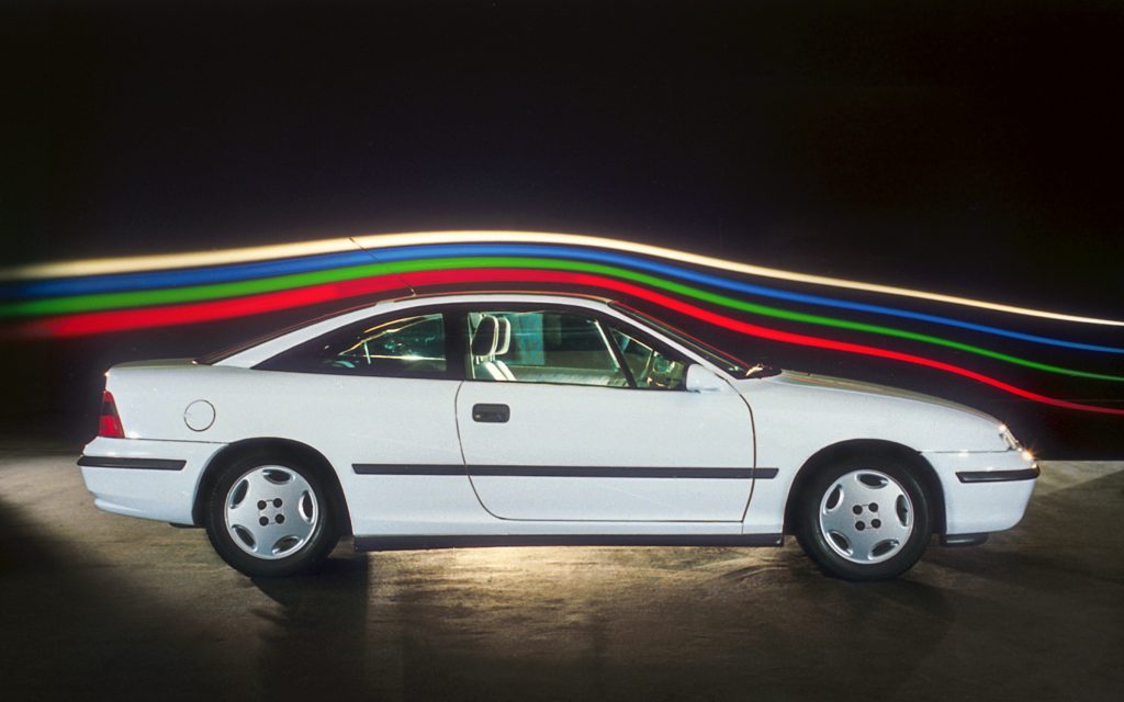

    Your Prime manages a 0.25. The 1989 Calibra is at 0.26.
    Don’t drag me down: 10 cars that mastered aerodynamics | Hagerty UK
    The ID.3, which got rid of that problematic frunk, is 0.276. Just 0.006 better its segment mate, the Golf. The Model 3 has one with 0.23. The Model S, Lucid Air, and EQS are all in the 0.20 to 0.21 range. Only the Mercedes doesn't have a frunk, but it does have what you would label a long hood to go with its cab forward design. The EV1 was at 0.19, and it had neither frunk or cab forward.
    An EV drive train needs less space than an engine. In most cases, designers simply can't get rid of the space gained, because there are other components. They did it with the bZ sedan, and ended up with raised front fenders because the wheels stilled needed to be there. The rest, whether a front trunk or more front passenger space, have traditional profiles.
    The hood length helps with aero design. Without it, you need a huge windshield, with its attending weight and fragility, or get something like the ID.Buzz with its drag coefficient approaching 0.30. Or end up with something like an high end sports car, which most people can't climb out of.
