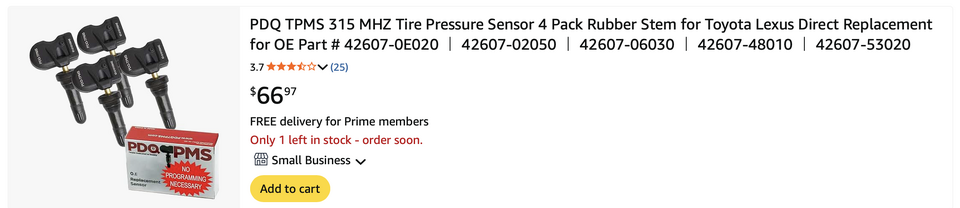

    The Amazon search results for '2026 Prius TPMS sensors' are littered with 315 mHz units. They call them 'preprogrammed' as well.

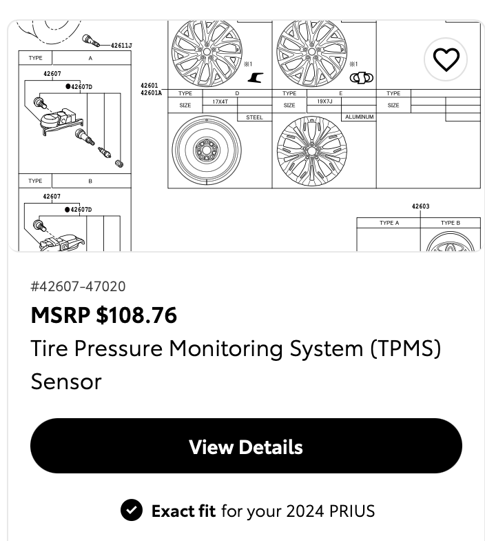

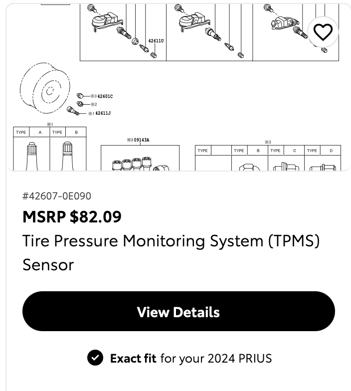

    Once again, everything I'm seeing says that the gen5 can recognize BOTH the current 433MHz sensors(which are what come with the car) as well as the legacy 315MHz sensors. However it's likely that the 315MHz sensors would need to be programmed with a scantool.
    The car comes with part numbers 42607-47010 or 42607-0E090(newest version). Both are 433MHz.
    The official Toyota parts website also lists 42607-47020 as fitting the gen5, which is a 315MHz sensor.

    edit: Doing some internet searches, I only come up with 315 mHz for those part numbers.

    For instance:
    (It's got the groovy rubber stem too, lol.)

    I contacted the nearest Toyota Dealership using my VIN# this is the part # they gave me 42607-0E090 but couldn't give me the mhz info lol

    Where you see the mhz in the pics attached?

    I didn't. I had to look outside of the Toyota page, as in post #29.

    Where are you seeing part numbers 42607-47010 or 42607-0E090 there?
    Mind you, the fact they're rubber-stemmed is supposed to indicate (according to Car Care Nut) that they're new style - so maybe those are new-style auto-programming 315 MHz ones?
    (I'm not sure if I'm 100% convinced that the metal/rubber stem thing also 100% correlates though, across markets. My spare set got yet another part ID 42607-02070 from the Toyota dealer, and they're metal stemmed, but I thought they were new style. )

    You are correct. Its says it's a replacement for 42607-0E020, my bad.
