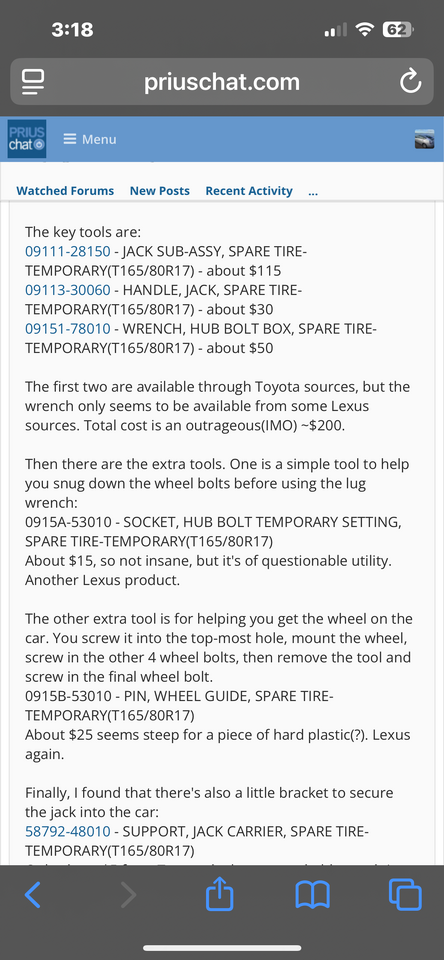

    If that first message was from me, it must have been a very old one before we knew the production car was going to have lug nuts. If it's not from me, it's just wrong. You don't need the lug nut holder or the wheel guide pin. Those were for the pre-production version of the car in late 2022 when Toyota was still planning on using lug bolts like the bZ4X instead of the standard lug bolts they eventually went with.
    The tool kit you need is 09105-47020. It contains all three of the tools needed and costs $73.37 if you order it in the next 12hrs. That's the lug wrench, jack, and jack handle. As for the towing eyelet on the uppermost left, that's already in your car. The sockets and extension are completely optional and I picked them up at my local hardware store. The red emergency triangles are also super optional. 81604-WAA01 and $14.14 each right now. I have three in there, but I was just being excessive and wanting to fill up the space completely.

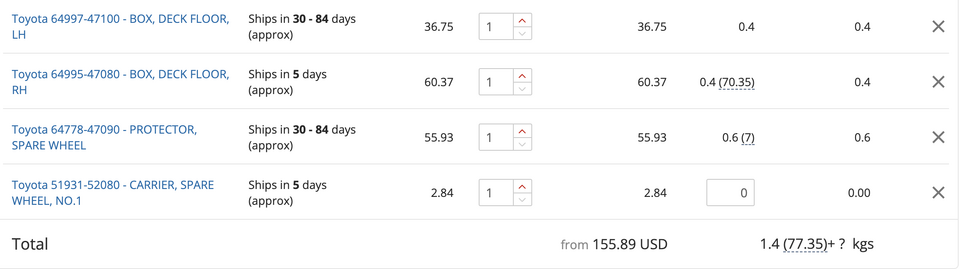

    Out of curiosity I priced out an OEM spare tire setup, less tire and lift. $155 before shipping isn't bad. Screenshot 2025-07-16 at 2.05.59 PM.png

    Curious what website you're using for those prices. I'm assuming that's from an importer? Yeah, the prices are good, but the shipping's a b!tch because the parts are so large. I bought my parts from Impex Japan because they weren't available in the US at that time. The price for the parts was maybe 1/4 of what what they now cost in the US, but the shipping was at least a few hundred. I just don't know if it's worth it for parts like this. If you go with an importer, make sure you get a quote for shipping before you commit.
    Current Impex Japan pricing:
    64997-47100 - $27.96
    64995-47080 - $45.93
    64778-47090 - $45.93
    51931-52080 - $2.16
    Total: $121.98
    Current Toyota USA pricing - plus 20% sale - includes free shipping
    64997-47100 - $75.50
    64995-47080 - $123.27
    64778-47090 - $123.27
    51931-10014 - $11.15 (effectively same part - different part numbers in different regions)
    Total: $333.19
    So you'd need shipping of less than $221 to break even.

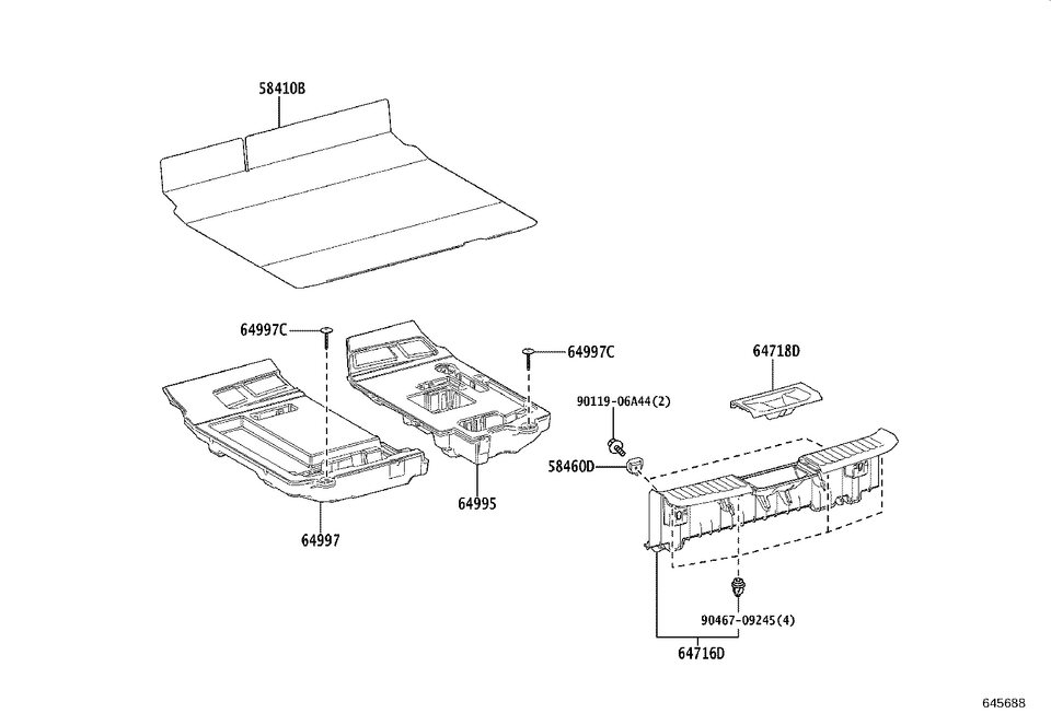

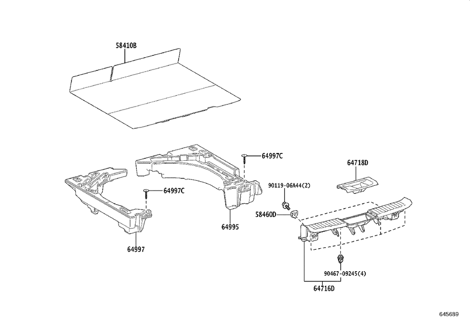

    You can also see the slight differences in the two deckboards in these part diagrams:

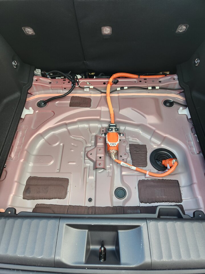

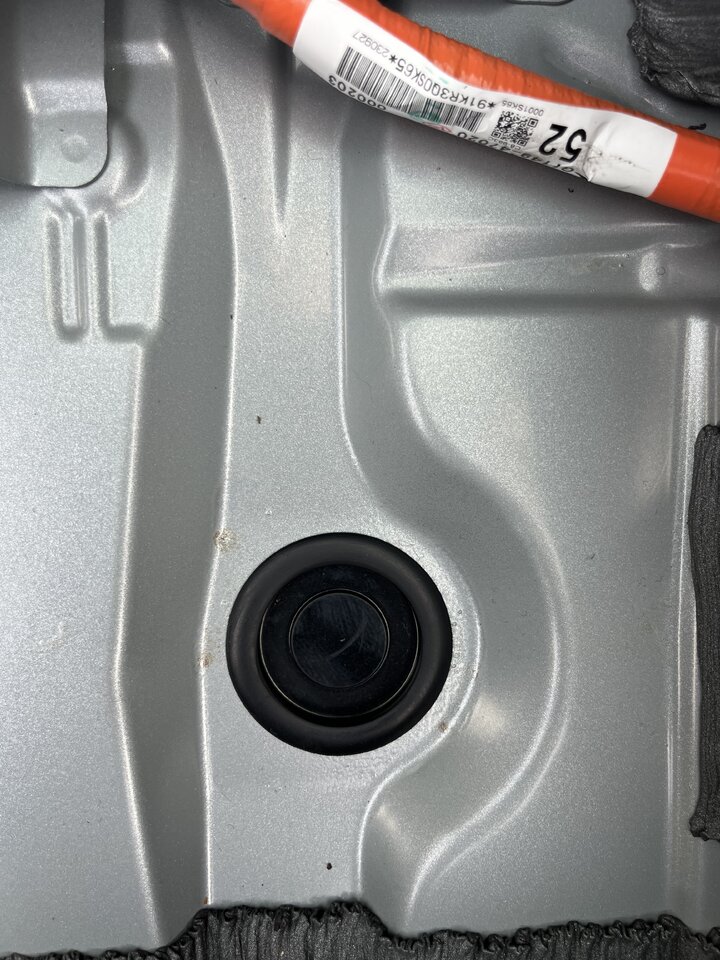

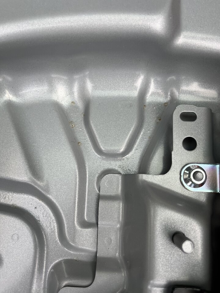

    I now have my spare tire installed. Yay! Do you recall seeing spots that almost look like rust coming through the cargo floor paint? I guess I’m one of the lucky ones. I remember people posting about this either here or on Facebook. I think one of the guys insisted the dealership refinish the surface. I have no intentions of doing this unless it becomes an issue. I showed the service manager and will keep an eye on it. Any ideas? Not an easy thing to keep an eye on since the spare tire is too heavy for me.
    I haven’t put foam blocks under the deck floor yet. I have the top of the tire wrapped in plastic because it’s causing my car to smell and then filled the empty spaces with bubble wrap for now. Obviously can’t load anything heavy on top. For the price of these styrofoam pieces they should have included a section to make it level. Oh well…relieved to have the spare!
