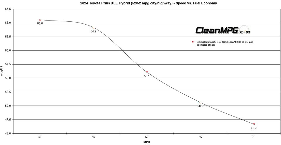

    Toyota went with performance and styling to turn around declining sales. While we don't get them, they have the Corolla hatch and wagon available as a hybrid for those wanting economy and utility in a car elsewhere.
    Considering the increase in power with handicaps from wheel choices the XLE/LTD gen 5 matching the gen4 in economy is impressive.
