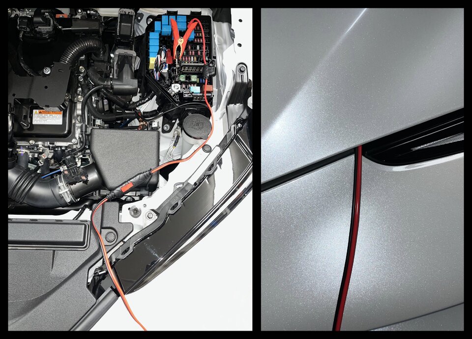

    Just wanted to show in attached image that in a 5th Gen Prius there's also a perfect slot available to route a charging cable under the hood between the rubber seal at the leading edge of the hood and the "tear duct" of the headlamp. I recall in my early attempts at leaving the hood up it seemed a warning kept appearing on the MID display that may not have gone away to my liking.
    VelvetFoot likes this.

    Thanks everyone for your help! I will use the post under the hood. That's where we jumped it.
    bisco and BiomedO1 like this.
