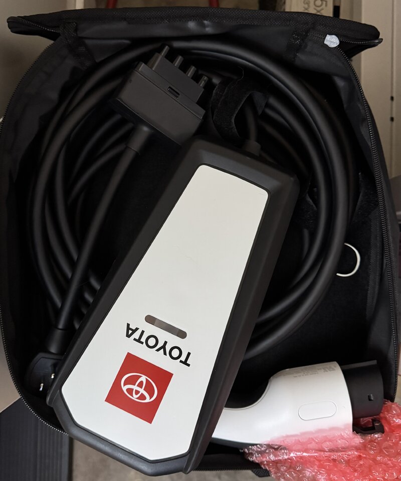

    can you post a pic of the adapter? it's kind of odd, because the evse can use 240v, though toyota doesn't recommend it.
    what kind of cover is missing?
    you can just put a weatherproof cover on the outside outlet, the evse plug is fine in any weather.

    This is the charger. I talked to the dealership today and the charger does support 240V, which makes sense. Why else would it have a 240V plug.

    XSE Premium
    Weird, they must have changed the charger that was included. Looks nothing like the one I got with my '25.
