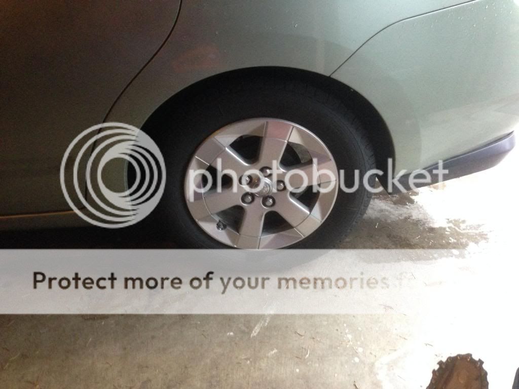

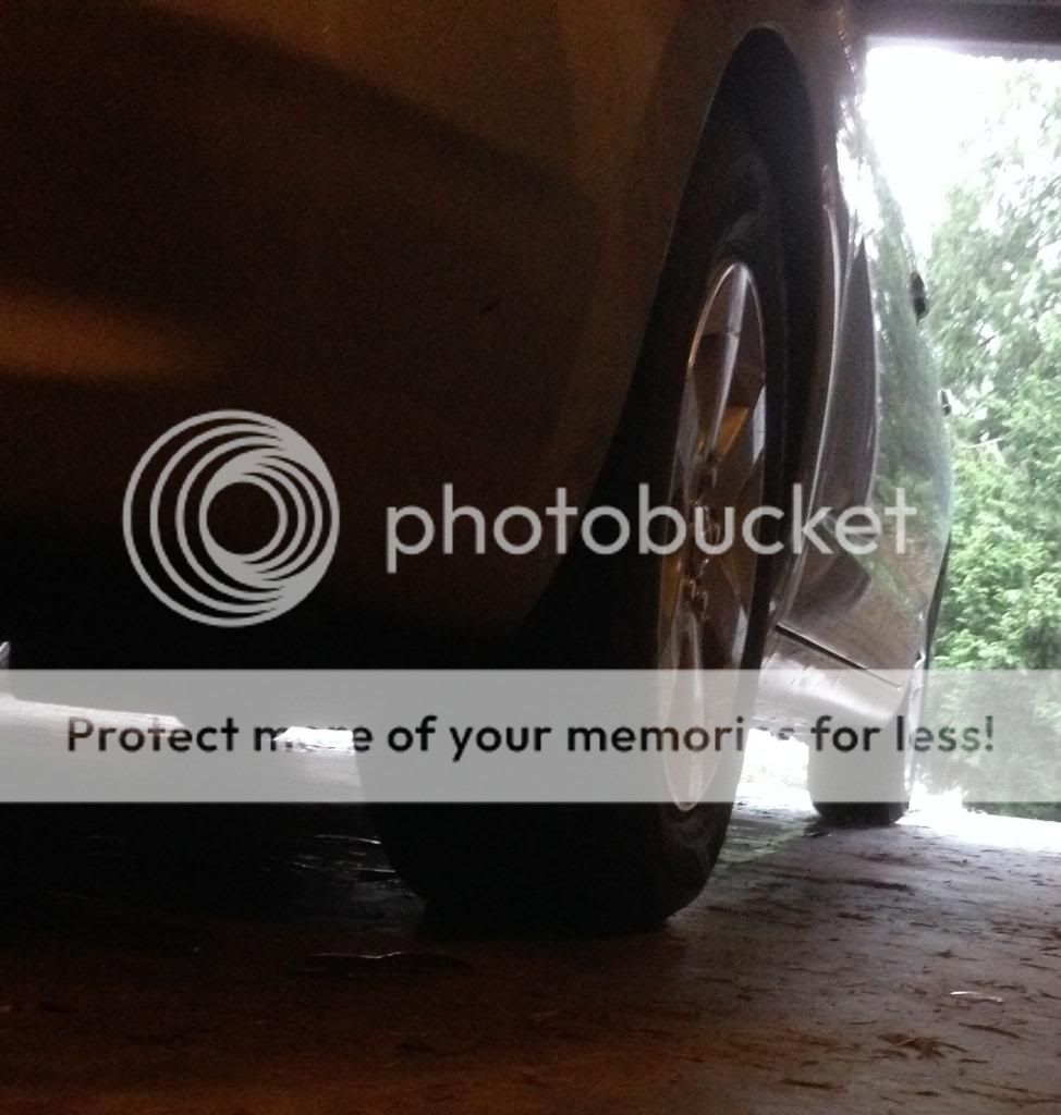

    Would love to see what these look like
  8. Shawnna
    Shawnna Junior Member
    Feb 2, 2014
    34
    Covington (near Seattle), Washington State, USA
    Here's a couple of pics.
