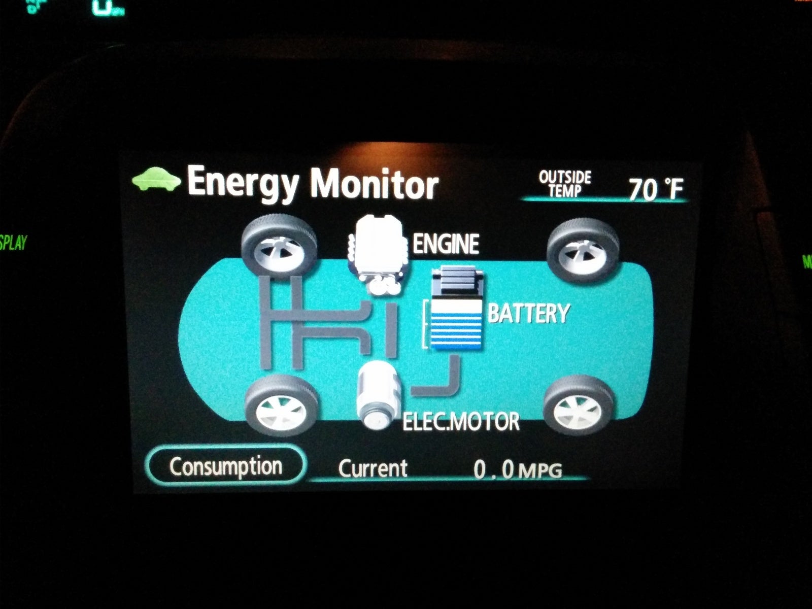

    I am also curious about this. If I get the display replaced, would I be able to insert a newer display, say from a 2009 Prius (not with navigation)? I am curious because I know the Prius from around 2006-2009 had a display with better-looking touch buttons and just a much nicer appearance in the software overall. Since my current screen does not have navigation, I would not try to put that in. Thanks! (This is a picture from the internet, and the software just looks much more modern then what my current screen looks like in my opinion).
