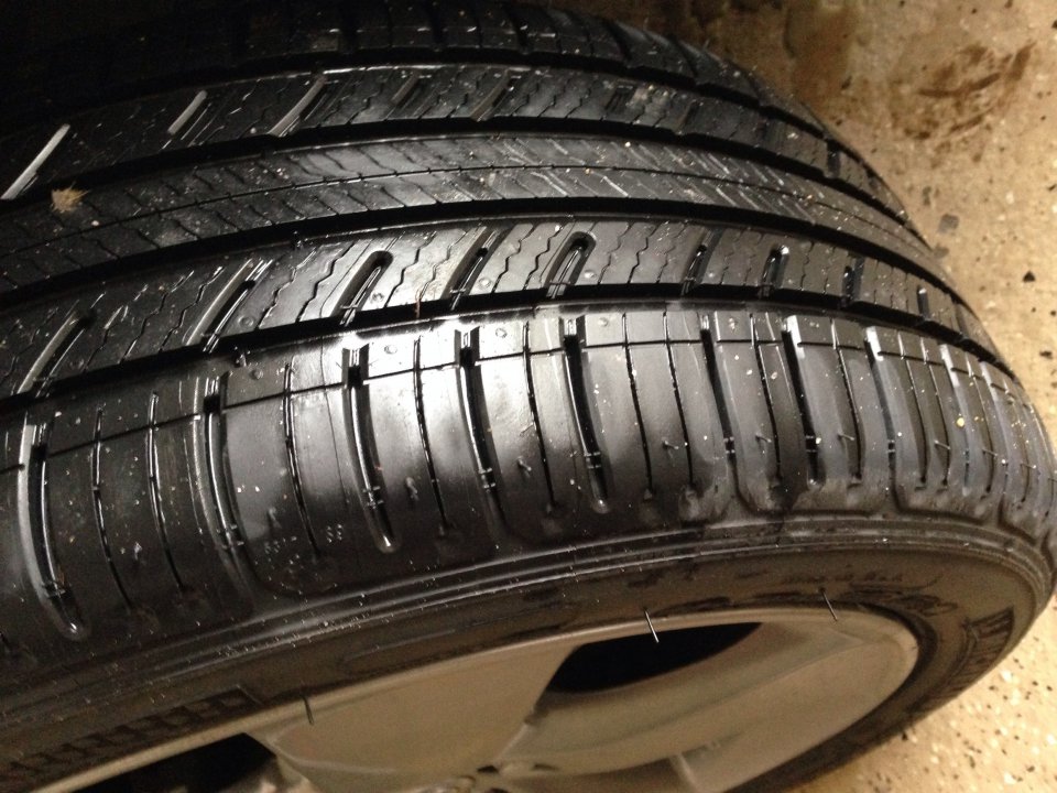

    The new Michelin premiere 215-45 /17 my impression. I've done 500 miles and I am very happy with them. I'm averaging 48-50 mpg. The ride is quiet. Very responsive , superb in rain. I did a lot of research before buying. I even called Michelin tech engineers. The premier is a very new tire by design. It was not listed as a low rolling resistance tire on any websight. Michelin verified that the primacy is a not a LRR tire but that is rated 10 out of 10 for its " green " characteristics and that it is eco friendly and improves fuel economy . It is 10 out if 10 for comfort and wear rating( primacy was rated a 9. ) I told the Michelin tech folks that I had the primacy mxm4 and wanted to replace with the same. "These are the replacement for the primacy. " They will replace with the primacy within 30 days if I'm not satisfied. That's there 30 day promise. ( very nice, and at no extra charge) The premier weighs 20.17lbs and the primacy is abit heavier at 21.50 pounds. (215/4517)
    This came from the Michelin tech specs. The premier also has the 65 k tread warranty and the primacy was 55k. Since I have owned the primacy before, the only thing I noticed was the the primacy is a little quieter on the highway . And the premier does NOT come with the rubber extender lip Gaurds. My opinion. Either tire is a good choice! Hope this helps someone else. It was a bit of leg work, so happy to share the outcome image.jpg image.jpg

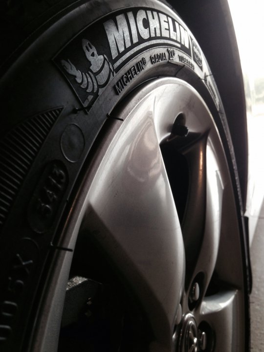

    Thanks for the review. Hmm, too bad it doesn't have the rim protector. FWIW, our rims are getting pretty chewed and the Michelin Pilot's on there DO have rim protector. I just keep dabbing on silver touch-up pen; our silver body color is a perfect match.

    I agree. The rim protector is nice to have. My wheels are from a persona series. So I think it's a different color. I bit darker perhaps. Thanks for the thought though.

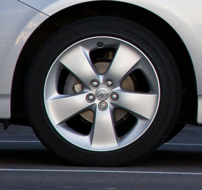

    They do look a bit darker, I think...
    Here's ours, shot near sunset:

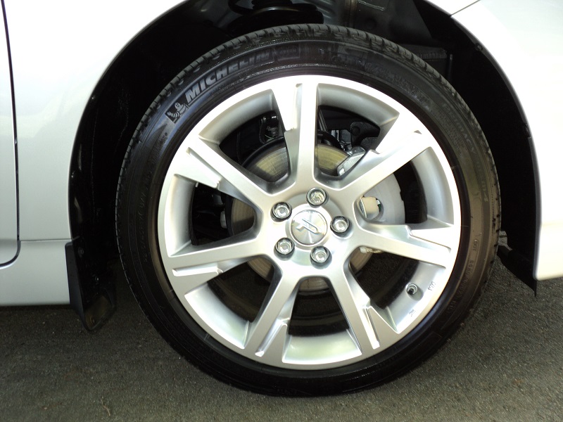

    I know what you guys are talking about the rims being easy to scuff up. I have already scuffed up one of those nice Ace Wheels that came on our Prius.
    If I understand correctly you are saying the Primacy is "quieter" on the highway than the new Premier. Is that correct?
    Here is a pic of the wheels and tires that are on our 2013. Came that way straight from the Gulf Coast Distribution Center. Come to find out the wheels are only available in our area. Very sharp looking in my opinion. Also very difficult to clean. Seven spokes with lots of grooves and angles...

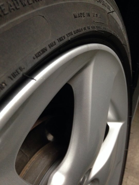

    Are you saying there's a rim guard on the Primacy, but not much? (in post #11)

    That's correct. Here is a photo. These tires are much better than the premiere for me.
