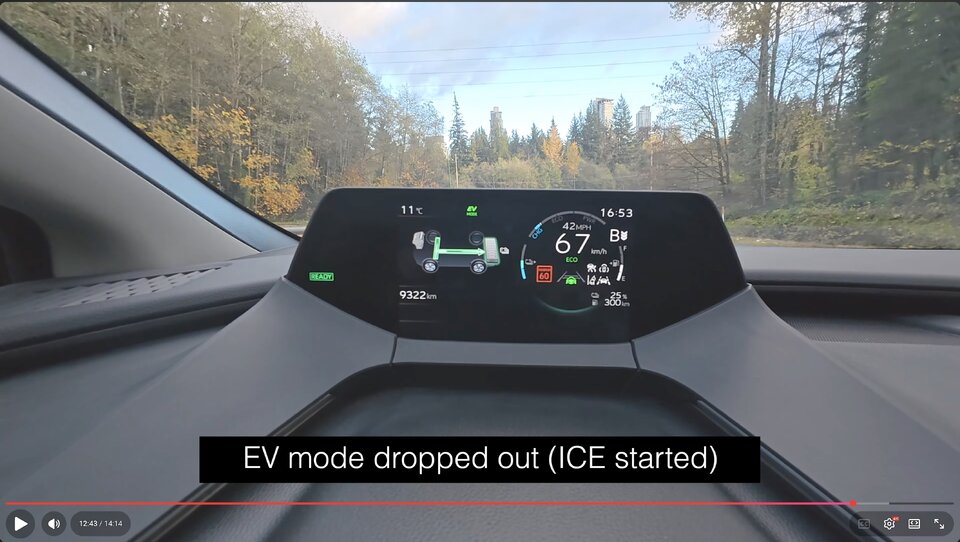

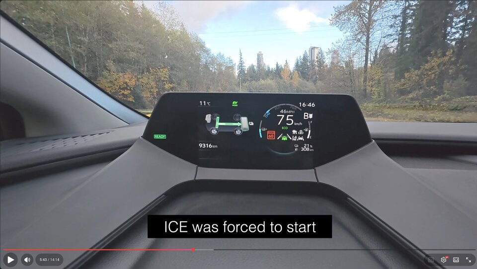

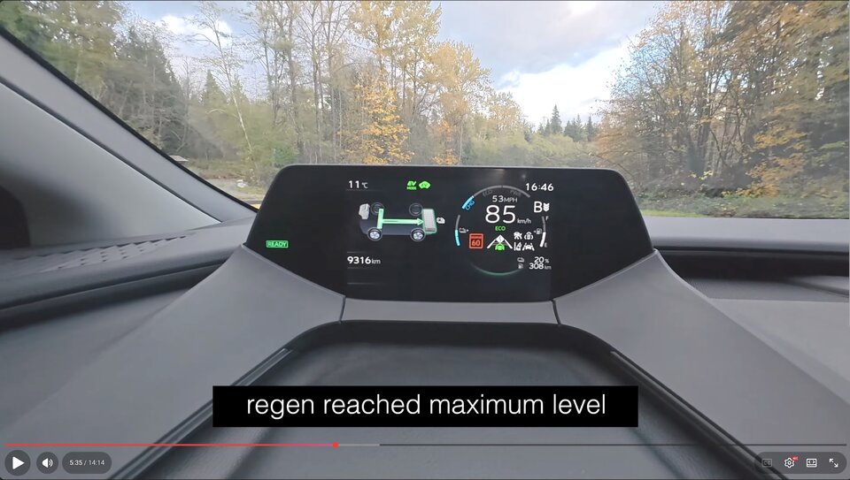

    Yesterday I had a chance to do some cross-testing on the downhill route I drive through frequently.
    Sorry, I don’t have an OBD tool to monitor data directly — I can only share what’s shown on the MID.
    (And please forget about my speeding — it was just for testing! )
    Test route: continuous downhill about 2.7 km, descending roughly 182 m in elevation.
    Scenario A: Cold engine, no prior ICE activation (low oil temperature)
    3:54 — start of test section
    5:35 — regen reached maximum level
    5:40 — ICE was forced to start (and did not stop immediately)
    Then I climbed back up the hill using ICE and switched back to EV mode at the top.
    Scenario B: Hot engine (after climbing with ICE), switched back to EV mode before descending
    10:58 — start of test section
    12:32 — regen reached maximum level
    12:36 — EV mode dropped out (ICE started)
    12:51 — switched back to EV mode automatically
    Video link:
    Observations:
    1. Every time the ICE starts, the regen intensity immediately decreases — even though the road slope remains constant.
    2. Oil temperature doesn’t seem to affect whether the ICE is triggered, but when the oil is already warm, the system switches back to EV mode almost immediately. When it’s cold, the ICE keeps running for a while before returning to pure EV mode.

    I can see your charge meter at 5:35 is maxed out but it raises a question. Is there a threshold where the charge meter tops out at for the display or are you actually reaching the peak of the amount of regeneration current when the charge meter is maxed out? I suspect it is the former but I will have to check next time I go for a drive.
    Than you say that ICE was forced to start. Your flow meter does not indicate that the ICE is on.
    So how are you determining that your ICE is running? It wasn't until 5:57 that your flow meter indicates your ICE is on.
    Also is there a reason you are driving with in 'B' set to maximum level while presumably ascending a hill at 80 km/h. Xnip2025-11-02_23-05-44.jpg
    In addition I think you are confusing two things. You have the EV mode indicator light which stays lit and the EV indicator. The EV indicator it looks like goes out when you are not using electricity to drive the car so if all the power for the car is being driven off of regenerative energy than the EV indicator goes out. Pretty certain when the EV indicator light goes out that it does not mean that the ICE is running.
    You are also saying on your video that EV mode changes when it is the EV indicator that is going on and off. Pretty sure this correlates with where the energy is coming from to run the car. If it is coming from the battery the EV indicator light goes on and if you are supplying enough regenerative energy to run all of the electronics than the EV indicator light goes off. For the most part EV mode only changes when you change the mode with the EV mode button or you run out of charge in the battery.

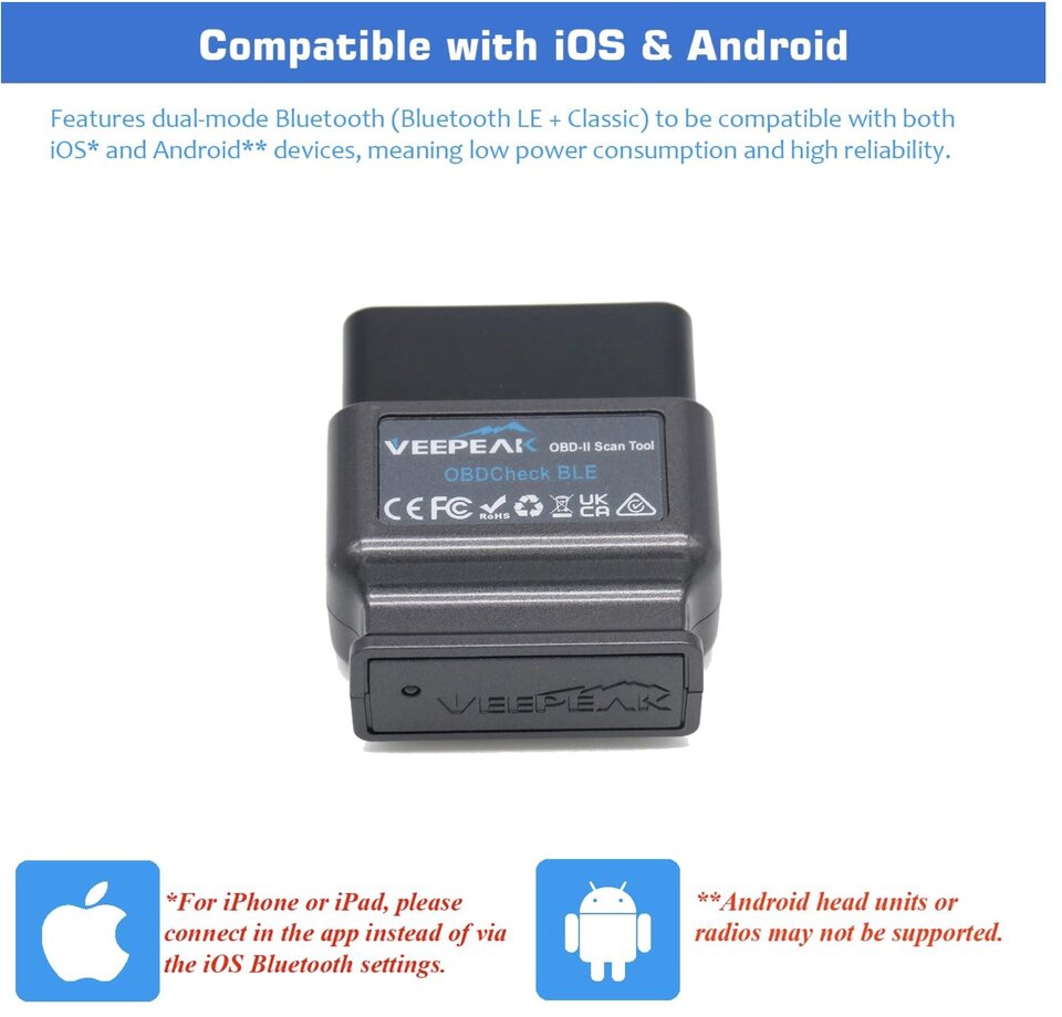

    I have gained a lot of insight about what the Prius is doing using the OBD dongle. From a quick look on Amazon it looks like you can get one for $32. Xnip2025-11-02_23-28-24.jpg
    There is also a bunch of apps that will give you information that can help in understanding what all the graphics are indicating and how much information is available that is not visible on the MID.

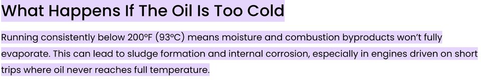

    Here is one answer.
    From the people at cartalk.pandahub. Never heard of them but it sounds pretty reasonable to me.
    Isn't he driving a 4th generation Prius Prime? There has been significant changes in the Prime powertrain between generations. Not exactly the best source when trying to figure out what is going on in a 5th generation Prius.
    My understanding is that there has also been a significant change in battery cooling between generations. The 4th Gen Prius Prime was air cooled whereas the 5th generation Prius Prime is liquid-based refrigerant cooled. There must be some significant performance changes in the two systems like maximum discharge and recharge rate.

    That's exactly what it means, as far as I've been able to determine, driving one for 2 years - the EV indicator is a simple "engine not running" light. It is not affected by the motive forces in play.
    But it's utterly irrelevant to a non-running engine. The non-running engine in a Prius in EV mode has as much need of oil temperature as a non-running engine in a parked car.
    Now, once it decides it's going to start spinning the engine, such as to provide drag, at that point the car has to worry about oil temperature, which is why it goes through a warm-up cycle.
    But spinning up an engine just to warm it up makes no sense for a car in EV mode that isn't planning to run the engine at all.
    Yes, that's 4th gen. It is the best source I've found though - if you can find or provide live OBD data from a G5 Prius including the instantaneous charge rate indicator, then we'll be able to do better. But it's the best so far.
    Sure, there are changes between generations. But the G4->G5 transaxle changes are pretty minor - I dug into them here where I described them as being on a scale similar to the G1->G2 changes.
    Battery capacity will likely have shifted the values for short-term charge rate limits, but it seems unlikely that the rate limit will have been totally eliminated.
    In the absence of a strong reason to believe otherwise, it's wisest to assume that generations of Priuses will do roughly the same things for the same logical reasons.
    So if we know the G4 has a short-term charge rate limit that triggers engine bleed-off regardless of SoC, and we also see G5s doing engine bleed-off at low SoC, it's not very logical to start from an assumption that it isn't doing it for the same reason as the G4, and trying to find a new different reason.
    Don't become Paul Gregory, and get incredibly attached to a wild guess, and actively avoid any steps that would help establish the verity of that guess.
    If you want to prove that the engine starts are due to some other factor than short-term charge rate limits, you need to find the instantaneous charge rate limit in your OBD, like john1701a's videos show, and demonstrate that it's not moving down so that it's breached.

  12. Mccoy
    Mccoy Junior Member
    Oct 9, 2024
    Vancouver
    2024 Prius Prime
    XSE
    I understand you’re trying to analyze all the clues and find alternative explanations for why the ICE kicks in, but so far none of them seem to fit very well.
    About 1 hour later, on my way home, I drove down the same hill again. When the regen bar hit max for about 3 seconds, I gently pressed the brake pedal to lower the regen level — and this time, it stayed in pure EV mode without being forced out. That completely matches my previous experience.
    5:45-5:48
    From my experience, the most reasonable explanation still seems to be a short-term charge-rate limit protecting the hybrid battery or inverter system.
    I’d definitely suggest you try it in your own driving conditions. After all, the whole point of this thread is to understand why the ICE kicks in. Since Toyota didn’t given us a clear answer, finding practical ways to manage it feels even more important, right?

    So, going back to the video, to try to figure out what you think you're seeing.
    0:00 - startup, EV light on, engine not running
    5:38 - EV light goes off
    That indicates the engine is starting. It always means that. And that doesn't necessarily lead to any flows. Try it yourself - put the car into charge mode, or turn on the defroster. The engine will start, the EV light will go out, and there will be no energy flows. Same applies if moving, if no energy is required, as in this case where we're going downhill and regenerating.
    You think the light is going off because the regen is high enough? Have you ever observed this? The EV light going off due to high regen with no engine start? I haven't.
    Note that the battery was charging before this point, indicating that we had "enough regenerative energy to run all of the electronics". So your explanation must actually be that "the EV light goes off if we have more than enough regenerative energy to run the electronics and charge the battery, and are hitting maximum regen."
    How does that make any sense as a useful light?
    5:58 - first power flow from engine
    But you think the engine started there? What's your explanation as to why it would have started there?
    10:05 - EV light back on
    12:35 - EV light off, indicating engine start
    As with the previous run, indicated charge rate drops to and stays below half after this, consistent with it applying the short-term rate limit. Although we can't tell what the user input was.
    12:50 - EV light on, indicating engine stop
    This would be consistent with the short-term rate limit being lifted again, but we don't see the charge go higher immediately - seems like the drive has flattened out, and we apply power just after
    13:05 - corner with high charge rate
    Can see nearly-max charge here again.
    Everything in the video seems consistent with my hypothesis, and the behaviour seen in john1701a's videos, and I'm seeing nothing favouring your hypothesis.
    You can have a wild hypothesis that "the EV light goes out without the engine starting near max regen, and mccoy is misreporting engine starts", but now you're arguing that the whole premise of the thread is wrong, and that the engine isn't starting when going downhill.
