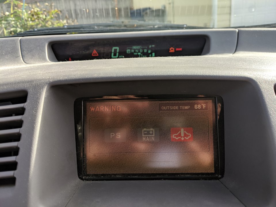

    We've had and loved are daily driver 2001 Gen 1 Prius. Other than a refurb traction battery replacement 7 years ago, we've had little/no repair costs.
    However I was greeted with the dreaded PS Exclamation Point of Death.
    I am not inclined to put a "new" bank in for the $1500-2000 for this age of a car.
    Before I send the car to rest, I thought I would post some pics ifanyone has a less expensive alternative.

    I'm not one of the experts here and haven't seen screens like you've posted before - have you pulled the codes yet? For example, if that screenshot suggests that one of the modules is failing, it might just be the wiring harness inside the battery. You can buy a new one for $100 or so, and it only takes a few hours of uncomplicated work to replace it. Or, if it's just one module failing, you can buy a single module for less than $100, and that's just a little bit more work to replace. That might be a temporary fix; once one module goes out, you should probably expect others to go out before long, but if $100 gets you a few more months of use, and you like the car, that's pretty cheap transportation.

    That particular Gen 1 error display over the years has confused more people than a William Barr statement:
    What you're really seeing here:
    • The power steering (PS) does not have a problem.
    • The main battery (MAIN) does not have a problem.
    • Some other condition (!), detectable by the HV ECU, exists.
    You'll find out what the other condition is when the trouble codes are read. It doesn't have to be anything especially expensive, necessarily.

    By your display you clearly have one module pair over charging, and one no longer taking a charge. By rearranging modules to equalize voltage, replacing 2 to 4 modules, and ideally hooking them all up in parallel for a couple days to balance i think you would be in great shape. It's a relatively low cost and moderate time investment to get another year or two out of the car.

    I don't see any serious red flags in those battery snap shots (like overcharge or not taking charge). The DSOC is obviously red-flagged, but that can come and go momentarily. If you track those things while driving they're all over the place. Two screen shots don't say anything.
    Not all red triangles are about the hybrid battery. I'm guessing that you don't have a Tech 2 knockoff scanner or you'd have said so and posted something about it. Search the forum for that and see if you want to get into that. Without an error code scan, no one can say what to do. You could have something as simple as a bad ground.

    Since the display on the MFD is telling you the car doesn't think there's anything wrong with the PS or the battery, only some other condition the HV ECU is detecting, one way forward would be to worry less about the battery or the PS, and just ask the HV ECU what the other condition is that it's detecting.

    As the OP has already posted an image showing that neither the power steering nor the battery have problems, it could be possible to devote too much attention to the battery and not enough to finding out what problem the car is reporting.

    odbo255 could take the car to auto zone and have them read the codes for free. Is the car driveable? I forget, not every body has an obdII reader that reads toyota prius codes. Look at the dash picture, the brake light is also lit (to the right of the check engine light). For me, that always mean there is corrosion on the terminals. I clean the HV battery terminals, reassemble it, drive it, sometimes the problem goes away. If not, I take the battery apart again and look for weak cells, change them out, car runs fine. Only one time did I get a prius where the owner never changed the transmission fluid. The engine would not turn over. the code said the HV relay was at fault. Guess what...that was wrong. I took the transmission pan off and the slug in the pan was covering the pick up screen. The poor little car only had 170,000 miles on it. I separated the engine and transmission and the engine spun freely by putting a 3/4" wrench (19mm for metric lovers) on the harmonic balancer bolt. It would not turn over before. Gen 1s have a "fixed" clutch plate. When I took the trans apart i found the planetary shaft was locked up. One of the four gears was in pieces. Another was missing its center shaft. Then I decided to look at the questionable "o-ring" on the trans screen pick up tube. It looked brand new. Change your transmission fluid people. The o-ring was fine.

    The screen is not indicating the PS ! as stated by ChapmanF. It is indicating the CAR ! . It is still and exclamaition of death screen. Not the end of the world. Just another challenge to get through.
