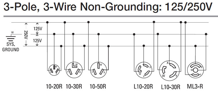

    Lets pretend you already have 240 where you can recharge. Look at the plug and match it to this list of NEMA standard Receptacles. (the R at the end, Plugs have a P at the end)
    There are very few styles of 120V receptacles, but tons of 240V. Once you know what you have, you can find an ESVE with that Plug.
    If you don't currently have a 240 volt receptacle near your car, choose one that ends -20 and does not start with L. (L stands for locking and if you forget and drive off, it will not come loose)
    I installed a NEMA 6-20 for my daughter's Prime, but it is no better or worse than the others.
    Many of these show you either the plug or the receptacle, some are just replacement cables.
