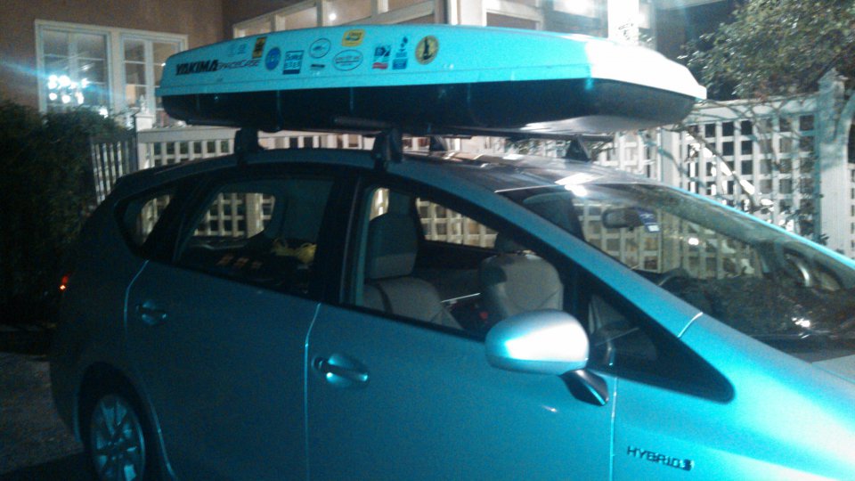

    If you are traveling at 80 mph you might want to use the Waze mobile app so you can have advance warning of speed traps. I drove to FL and back 2 weeks ago - 1,500 mi. Drove close to 80. No problems. I had a Yakima cargo carrier on the roof. Wait one - I'll find a picture.

    What was the mpg difference with the carrier?

    I find it's a loss of 4-6 mpg

    It was significant - BUT it was still way better than the Suburban I was driving. My usual rate is 45 mpg. For the trip with the rooftop box I got 35 mpg. I'm happy with it since I had the use of this great storage space. We drive from Ohio to Florida Emerald Coast. Our lab rides in the rear and we put much of our gear on top so Lola can have a comfortable space.
