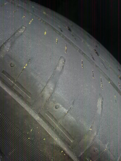

  19. catgic
    catgic Mastr & Commandr Hybrid Guru
    Jul 7, 2007
    586
    141
    HTTP 404 Not Found
    Gathered Prius Pilots - FWIW FYI, here is a snapshot of the OEM Toyo Proxes A20 P215/50R17 90W tires on my Prius v(vee) taken recently at 25,550 miles. They all look like this tire in the photo.
    I run them Up-Pressured at 51 PSI Front/50 PSI Rear. Honest Abe says, "I'm doing fine with mucho miles of driving remaining on them."
