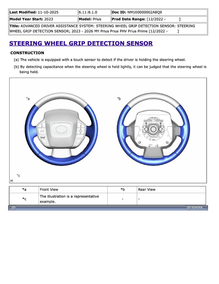

    If Gen 5 got rid of the capacitive sensor on the steering wheel and relies solely on constant driver input to detect driver presence, that is very inconvenient.

    Had that in a Subaru and Acura. It's just an issue of the steering wheel torque sensor not being sensitive enough for a light touch.

    Capacitive sensor exists depending on where you hold the wheel. 12-clock hand position not capacitive but will generally fail due to the driver monitor camera being blocked.

    The capacitive sensor is part of the hardware equipment for the Lane Change Assist + Front Crossing Traffic Alert feature bundle, along with the front side radar.
    In America, that's only in PHEVs.
    In Europe, that's all cars (and they're all PHEVs).
    In Japan, it's standard for Z trim (including all PHEVs) and an option on U trim. Not on G.

    Yes, the OP got a warning about a system malfunction, and to see the dealer. I got no warnings aside from the one about hands on the wheel. Then the Subaru doesn't have a capacitive sensor to detect hands on the wheel. Just the torque one to feel the weight of a hand. Pretty sure it's the same with the older Acura I was driving.
    I assume the cars using a capacitive sensor on the wheel have it in addition to the torque sensor.
