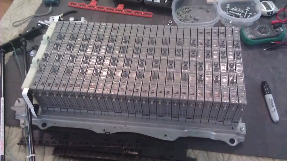

    got a new code on the battery, it says block 13 can become weak.
    ive been driving with scanner and when the code hits, i clear out instantly to keep from going into limp mode and isolating the battery.
    i got battery out last night and have it apart this morning. the cell blocks are testing around 15.30 on average. i tested individual cells and they all read about 7.65
    im curious if anyone knows which exactly is block 13? is it closer to the pc/relays or on the other side of the battery?
    i got 3 batteries for replacements/spare

    no, but would like to keep it running for 6-12 months til i can get 3rd gen battery set. also when i say 3 i meant modules/subpacks

    replaced block 13 closest to pc/relay of battery pack, drove a few times on sunday with no problems
