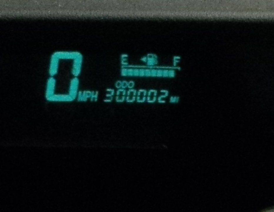

    I just joined the 300k club last night!
    2008 model bought new in Oct 2007.
    Had to replace the ICE at 292,500. The old one burnt through a piston.
    I accidentally reset the mph back at 150k when I was having headlight issues and I was playing with buttons.
    Whoopsie...
    Before the old ICE started going south I was averaging 45.6 mpg and it was about the same on the 1st 150k.
    I haven't put the grill blocker in for winter yet and since it's cold now, the mpg is down to 44.5.
    Oh... and the speed limit on my main route to and from work has increased to 70. I sure that has nothing to do with lower mpg... :ROFLMAO:
    The main battery is still going strong.
    This little car has more than paid for itself!!!
