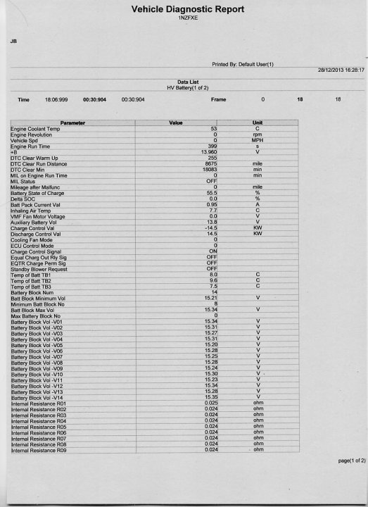

    A good place to start is with a Mini VCI and Techstream software. This is basically dealer level equipment at a bargain price of $25.
    It requires a lap top pc to work preferably an old 32 bit Windows XP version as this is the easiest to set up.
    It will give all fault codes and sub codes for the Prius or any Toyota Lexus Or Scion. It will also give engine codes on most other cars.
    It will let you bleed the brakes, set steering angle zero point, and the brake solenoid setup. Program key fobs and so much more. Part of the HV battery printout below to give you an idea.
    John (Britprius)

    The Prius does have a very limited diagnostic capability, but nothing really that is of any use in the workshop. If the Mini VCI is used once it will have more than paid for it's self.You will never go to the dealer for diagnostics again as it gives the codes and a guide to what is wrong. They are available on Ebay and Amazon and come with the program software.
