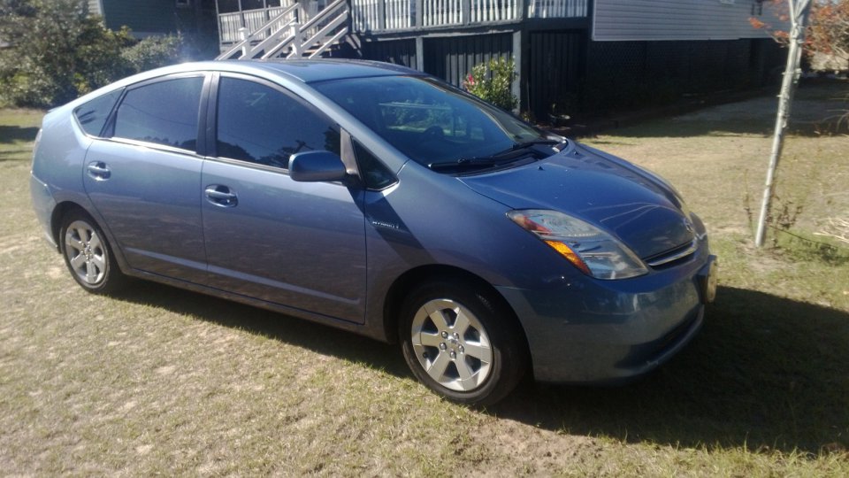

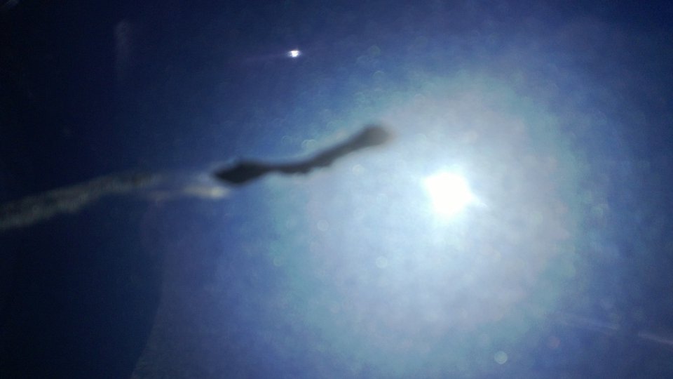

    I am looking at a 2008 Prius that has 117,000 miles on it. The owner wants $7000 for it. It has a 2" scratch under the headlight. I have checked Toyota owners website with the VIN number and looks like the auxiliary battery and the navigation/sound system was replaced. On a repair note I found:
    "RED-ENGINE SEALS/GSK: BASED ON MULTI-POINT INSPECTION ONE OR MORE SEALS AND/OR GASKETS WERE FOUND TO BE LEAKING AND RE QUIRE ATTENTION AT THIS TIME. ~|~ ~|~CUSTOMER HAS OPTED TO POSTPON E REPAIRS TO LEAKING SEALS AND/O R GASKETS AT THIS TIME."
    I am not really sure what that means. Do you guys have any idea what needs to be done and how much will it cost. Also how much do you guys think will I have to spend to fix the scratch.
    The car is located about 350 miles from my place. So I have to make sure I know how much will I have to spend for the repair before driving all the way over there. What do you guys think of the deal? Should I go for it?

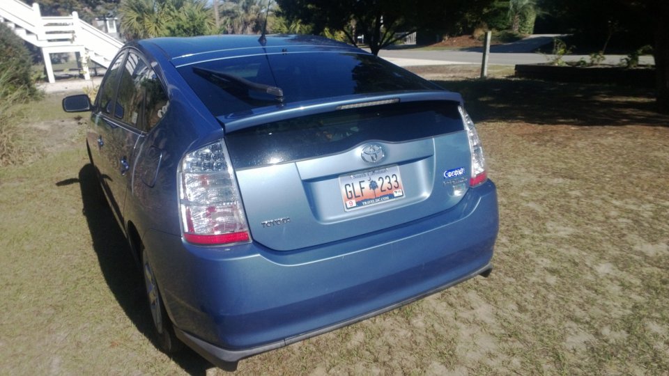

    One thing that puzzles me is this. You wrote "navigation/sound"... - When I look at the pics this looks like a base model to me. That means no navigation. Something doesn't make sense to me. Maybe I am missing something. I thought the 2008 had the black buttons like the 2009 for the SKS. I don't see them on the car pics you posted.

    Concerning the scratch - Average paint work (clear coat too) per panel $1000. If you talk to a body shop man, he will say about the same thing. So, figure somewhere between $500 to a $1000 to fix the scratch. You can buy some touch up paint and DIY a whole lot cheaper. Won't look perfect, but will be a LOT cheaper.
    7K sounds cheap to me. Price will vary due to location.
    I would not worry about the scratch. I would want to know about the "red" on the "Engine" side though.

    The owner should be able to tell you what package/model the Prius is you are looking at. To me it looks like a base model. I don't see the black square buttons for the SKS, plus the wheel covers are the OEM 15" ones. I also don't see a backup camera on the rear hatch, which would be missing on the base model. Also no fogs up front, so probably halogen headlights which is good. Lots of problems with the HID's it seems. Bulbs are not cheap and they seem to wear out fast.
