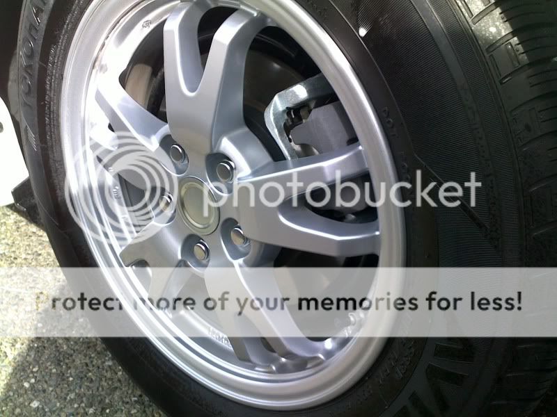

    Thank you so much for the great idea. I got mine for 88¢ ea. but i took it one more step further. I didn't like the cheap unfinished metal look to them, so I took a little of the Aluminum/Steel polisher powder for my pot and pans and rubbed them for a couple of mins each and now they have that polished satin finish that matches the rims much better IMO. Here's a pic

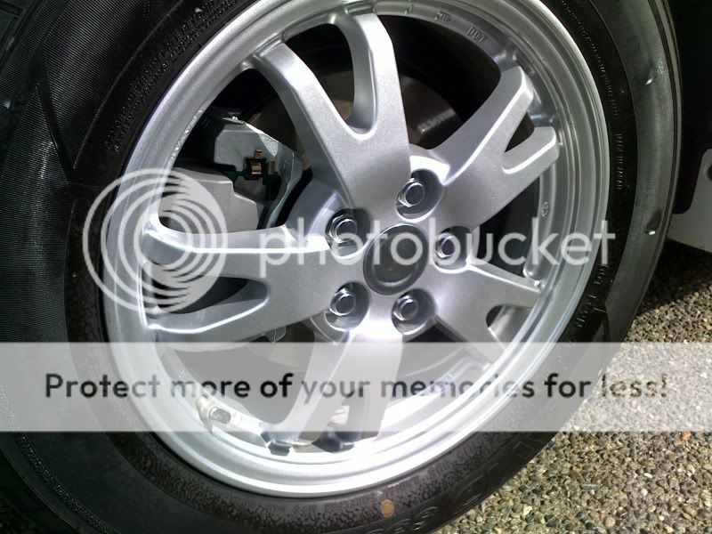

    Here's my two Yen, for whatever its worth. First and foremost, the reason I found the beautiful rims behind the cheap nice person hubcaps is because of this thread. For that, I thank you greatly! Secondly, while the proposed center caps seem like a good idea, they really aren't (sorry). The electrical plug tangs are actually fairly sharp and you have to bend them out quite a bit for a 2011. I can't speak to other years, but I assume they are the same. Its VERY EASY to scratch the alloy rims if you aren't VERY careful. I decided to order the Toyota chrome center caps from Parts.com and they look great! That being said, Parts.com sucks and it took them over 3 weeks to ship these to me, for approximately 53 bucks. eBay is definitely the way to go. But, like I said, the rims under the ridiculous hubcaps, are really great but I would advise against this particular 'mod'.

    Well, I've had mine on and off countless times during the process of painting, fitting center medallions, etc. (along with installing them on 4 other Prii) and have yet to scratch anything but my finger.:rolleyes:
    A possibly solution might be a can of "Plasti-Dip" (made to insulate or create grips on tools-about $6 at Lowes), Just dip the offending tangs and let them dry. Should eliminate even the slightest chance of scratching, and might even reduce the need to bend the tangs out quite as far.
    Even with that purchase, you're still under $11 for the whole set of metal (not plastic) caps.
    Just a thought....

    Our Home Depot only had the covers with the "1 1/2" stamps on them, so I rummaged thru the entire box to find four that were lightly stamped. Also looked for other surface defects.
    Then I went to the paint section. Rustoleum Metallic Matte Nickel (7277830) worked out nicely. It's very very close to the Toyota wheel color. After bending the tangs out enough so that they appeared to be ready, I wrapped electrical tape around the tangs (two at a time, so that the electrical tape sticky side meets between the tangs) then popped them in.
