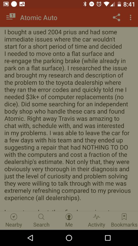

    Is your shifter notchy? There is no way from my professional experience that your car needs three computers. You have to take the Toyota engineers fault tracing procedure with a grain of salt sometimes. I'm curious what's actually wrong, but I would wager it does not need three computers. Did a north Korean neutron mini missile attack your Prius and simultaneously ruin the three computers? Could be the PCON motor, shifter, numerous things making the computer get confused. Remember this is an Atari, not a MacBook. Get a mini VCI. Scan the car with techstream and save a .tse file with freeze frame send it to me I'm glad to help you with diagnosis or do a video call and walk you through what to check on the data list. This Yelp review I got for fixing the exact same problem. Was not any computers, but this client was told the exact same thing that you were because somebody just read the diagnostic tree....... Just sayin........[​IMG]
