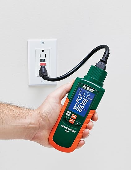

    I recently played with one of these interesting testers:
    You just plug it into an outlet and it shows you the voltage in real time (rather like a voltmeter, that). Then you push a button and it shows you the % voltage drop, and the voltage in real time, at 12, 15, or 20 amps.
    You hold the thing in your hand and it doesn't sear you, so clearly it isn't just sitting there drawing 1440, 1800, or 2400 watts and showing you the voltage. :)
    With a little bit of further investigation involving additional kinds of toys:
    it turns out what the thing does is take one very short 15 amp sip the instant you push the button into voltage-drop mode, and it remembers what the voltage drop was during the sip, and calculates the percentage. Then, just to make everything that much more convincing, from then on it reads you the real-time voltage scaled down by that percentage. :) When you set it for 12 or 20 amps, it doesn't take another sip, it just assumes Ohm's law applies, and it shows you the numbers based on the 15 amp sip, scaled proportionally to 12 or 20.
    Kind of entertaining....
