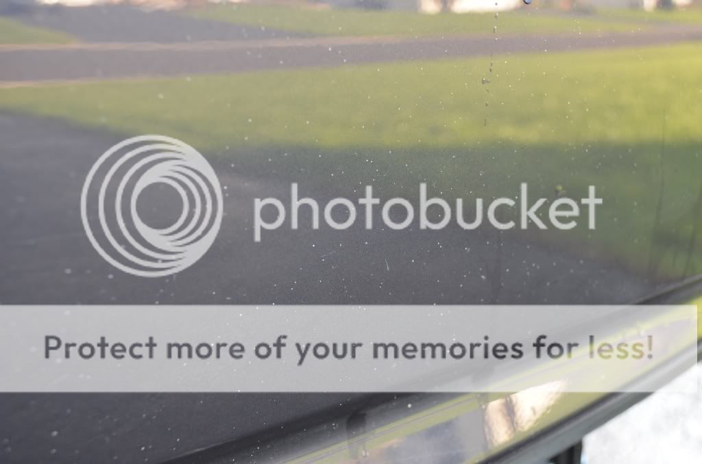

    *UPDATE* 30k update, paint suffering major road rash.
    *UPDATE*
    Heck, y'all were right. I have no idea what these specks were but I just rubbed a few off with my fingernail. I've seen specks of rust like this on a white car but these are white specks and mostly circular. Anyway, thanks! I guess the paint isn't suffering such road rash after all :) I'm told by SO there was no driving over fresh paint, but who knows. It covers a great deal of the car like it's happened a lot of times or was involved in some nasty spray or something (we don't bring it to the car wash, though).
    Here is the paint after a fresh wash at 29,900 miles. Pretty bad. I don't even know how that happens on the rear bumper for pete's sake but you can see a ton of white specks there where seemingly anything that so much as thinks about touching the paint is going to leave it speckled. It looks fine from a distance but up close there's no hiding this. I leased the car @ 18k/year. I can only imagine how it will look at 54,000!
    I don't drive many highway miles, mostly suburban type stuff, no dust or gravel roads whatsoever. Does suffer some salt collisions in the winter, though.

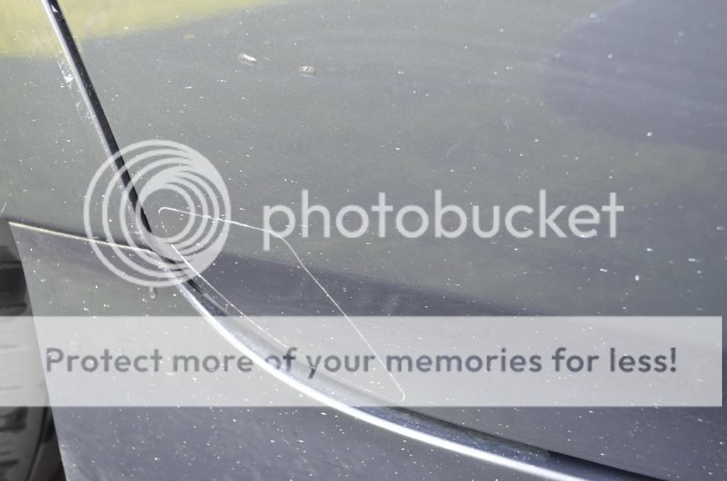

    You have spots on the piece of clear plastic on the lower rear corner of your back door. You wouldn't have chipped through the paint there. It look like you have something on your paint rather than road rash.
    Have you taken a close look?

    Are you sure that's clear plastic? I assumed it was painted. I didn't look closely, but I'll do that. It had occurred to me that maybe these were some kind of residue from something else, but I took some scratch X to one section of paint and nothing came off, so they really do seem like damage to the clear coat. I'll check out that plastic section later in closer detail and rub at it for a while with a clay bar to confirm...

    That's what I was going to point out. My guess is that it is soap residue from the wash or you might have run over a freshly painted road marking and have some paint reside - my wife did this last week with her car - the pressure washer and a shammy worked wonders.

    If it's not residue of some sort it's not damage to just the clear coat. It's gone thru the clear coat, thru the paint, and into the primer. One thing I noticed about the Prius is how ridiculously thin the paint/clear really is. They should have an option for a 2x or 3x layer of clear when you buy the car.

    OP, xs650 has a good point. That plastic piece would have reacted differently to chipping. Maybe you got some "up spray" from a road where new white lane lines were just painted? If you have any paint thinner, you could experiment on a very small section and see if it rubs off.

    Go to Wal-Mart and buy a Meguir's clay bar kit.

    OK - good to know. Be careful if you decide on a solvent to remove the specks. Prius clear coat is not too forgiving. Don't use rubbing compound. I've already guffed an area of my car that way. Try a solvent on the the lower rocker panels first - least visible. Quickly remove the solvent too. It still looks like a big job to correct.

    Look like salt deposits to me.

    I'll try clay bar first, if that doesn't work I'll try scratch x 2.0 better, but I think the clay should do it that stuff is pretty magical.
