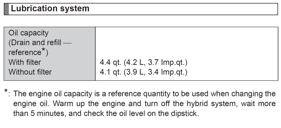

    Which one do you use the Gallon Jug (3.78 Liter) or multiple Quart Bottle (946 mL each) ?
    Because the owner's manual says to refill 4.4 qt. (4.2 L) with filter or 4.1 qt. (3.9 L) without filter.

    In my case it is 4L to the Max level with a filter change. Try 3.8 L first and you will be at the mid point.

    Would it be ok to fill up 3.78L with a new filter?

    Yes, minimum is 3.5L, maximum is 4L. At least for my 3rd gen with catridge filter. if I put 4.2L, it is always 3-4 mm above the max line and I leave it alone and never cause issues either for less than 1L overfilled.

    I drain the oil with the front raised quite high, which may assist with draining the last at the bottom of the pan. Also, I'll start it draining, then go inside for a while, let it drip. Anyway:
    After all that, I put a measured 4.2 litres (using a graduated pitcher). I don't even check it then, leave it a few days, drive the car, let it sit. Then, checking the oil first thing in the morning, level slab, it's about 3~4 mm below the top mark on dipstick.

    That makes sense, I drained using a Jackstand that was just enough for my hand to remove the filter. I did not raise it too high from the right side (engine side) of the car. 4L is just close to the Max line.

    It is not an exact measurement. Many factures involved. How much is completely drained.
    Is the car level?
    Just check the level afterward. It's always best to keep it near the full mark. But if it's half way
    it's still okay.

    I've found right after refilling, even if you've run the engine a minute, filled the oil filter, it can read (erroneously) high. I've learned the hard way to just put in the usual, ignore it for a day or two before checking.

    What do you suppose it is that when I change the oil and the filter dumping 5 quarts in brings the oil level exactly to the full line?

    I think 5Quarts is overfill but still OK. It is up to you. I usually starts with 4Q or 3.8L, It is right at the middle but I usually top it off till max line or about 4L, 4.3quarts. I only jack the car from the passanger side so I have space to open and fold the engine cover to drain the oil.
