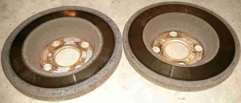

    There are some minor regular checks and maintenance items that you should stay on top of if you want to get the celebrated theoretical life out of your Prius brakes. The regen means the frictional wear is really slow. But rust never sleeps, regen or not, slide pins get sluggish, etc. If you rotate your own tires, everything you need to check might add an easy 20 minutes or so to the job (add maybe 1/2 hour if you find the start of rust trouble you can sand away) and cost you nothing. Just basic car ownership rituals. Stay on top of those things and you might have original brakes for the life of a Prius.
    Benign neglect for 100,000 miles isn't a good strategy, because any small problem undetected in that time can easily balloon until pads, rotors, etc. are toast.
    When I say "rust never sleeps" I don't mean the light surface rust that can regularly spring up on Prius brakes after damp weather. That makes a bad sound but is completely wiped off if you shift to neutral and stop a couple times. That needs no further attention.
    However, rust on other areas of the rotor where the pads don't wipe it off can be a growing problem over time. One example is where it starts at the edge of the rotor and starts to work its way down. By the time it spreads to where the pad is, it is too thick to be wiped off. Instead, it chews away the pad. Then it can spread even further, a continuing cycle. Eventually you see this:
    That was too late for hand sanding. If you simply keep up with inspection (say, no further apart than a year), your hands and a sheet of 150 grit paper will keep you from ever having to see that.

    A while back, some thread reported rotors available at NAPA that had a polymer coating, making them extra rust resistant (except for exactly where the pads rub the coating off, but that keeps the rust away there too). And in that thread they were something like $40, so a better price than the dealer.
    That doesn't seem to be the case anymore. NAPA does have a few different rear rotors for a Gen 3 liftback.
    There's the "premium" one, which has a phosphate and "graphite guard" coating, and is advertised to pass a 120 hour salt spray. It is priced at $69.49 as I write this.

    And there's the NAPA "Adaptive One Coated", with the polymer coating, rated for 300 hour salt spray. It is priced at $109.99 as I write this, $32 higher than dealer list ... almost double a dealer discounted price.

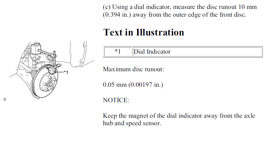

    On each side, I followed the repair manual recommendation to try the rotor each of five ways on the hub, and pick the one with least runout.
    On the left side, on the second position I tried, it actually had zero runout. Dial indicator needle didn't budge. (I didn't bother trying the three remaining positions. :))
    After a little test drive, that one stayed a little extra warm, and I put that rotor back on the first position, where it had a couple thou of runout, just enough to help knock the pads back a bit when not braking.

    ”On each side, I followed the repair manual recommendation to try the rotor each of five ways on the hub, and pick the one with least runout.”
    what does this mean? Alignment is checked by monitoring runout of fluid? I cannot follow, sorry
    edit: nevermind, i figured it out
    #14 OptimusPriustus, Jul 16, 2022
  15. ChapmanF
    28,624
    18,954
    For anybody else who might also wonder:
