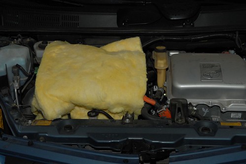

    FYI, for a time I did insulate the entire engine (or as much as I could), but was advised that the fiberglass insulation I was using probably wasn't safe so ultimately removed it. I also had the reflective insulation on the underside of the hood. I do think it helped keep the ICE warmer, particularly during gliding and such--maybe just b/c it reduced the amount of cold air circulating around the ICE. Worth considering, along with regular use of the EBH, in your area--I bet you'll see a nice improvement in your first 10 minute MPG.
