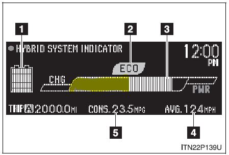

  20. Mendel Leisk
    61,446
    42,286
    A few comments on the above:
    1. If you change the display to show this:
    it's easier to slip the car into electric-only, and keep it there. If you completely lift off the gas, then gently re-apply, while keeping it to the left of the center line on the bar (yellow highlight zone), the engine should stay off. Get too good at this, especially under moderate load, and you'll start to run the hybrid battery down excessively. Arrrow number 1 points to the hybrid battery state of charge indicator.
    Running the hybrid battery down is not terrible, it'll just force the engine on, but use this trick moderately, you'll cut engine use without downside. I'd back off from this tactic if hybrid battery charge has dropped to around half.
    2. I'd reserve B mode for LONG hills only. Like coming down ski hills. To slow on short down grades, just use the brakes as usual. B mode reduces battery charging, it's intent is to protect the battery from overcharging, coupled with protecting the brakes from overheating.
    3. Is that a typo on the tire size?? Correct size should be 195/65R15? If they are 185/65R15, that might be a factor.
