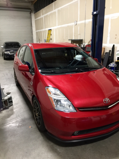

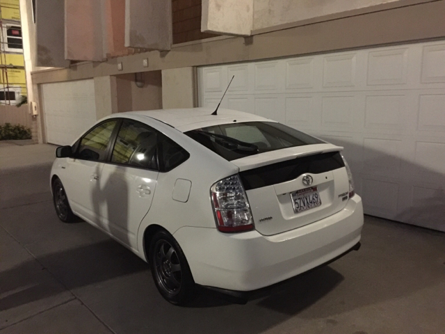

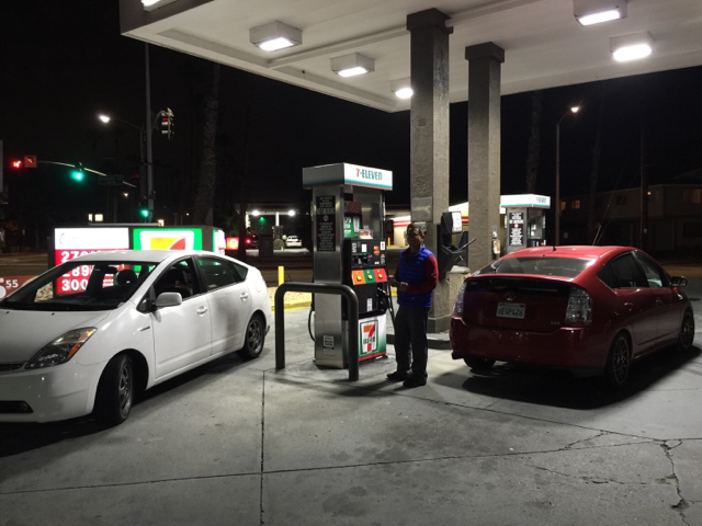

    Today I bought another Prius (a white 2007 touring package with 16" tires) for my gf and my coworker (professional test driver) and I drove it to her place - 25 miles away.
    Both of us were driving at the same speed (not close to each other to avoid drafting) 55-65 mph and we were using the same accessories.
    The Prius that I got for her had more than $3k in recent receipts (all services at the dealership) and recent battery for the motor replacement. It rolls on stock (for touring package) 16" wheels and it's a 2007 model with 140k miles.
    (Notice the beautiful long spoiler)
    My car is 2008 with 130k miles and had a new 12v battery - since it's a California car the batteries should be still under warranty.
    I have 17x7.5 wheels with (oem spec Michelin 215 tires - same as the forge package of the 3rd gen).
    I typically don't care about my mpg but this time I wanted to check my mpg against the new vehicle.

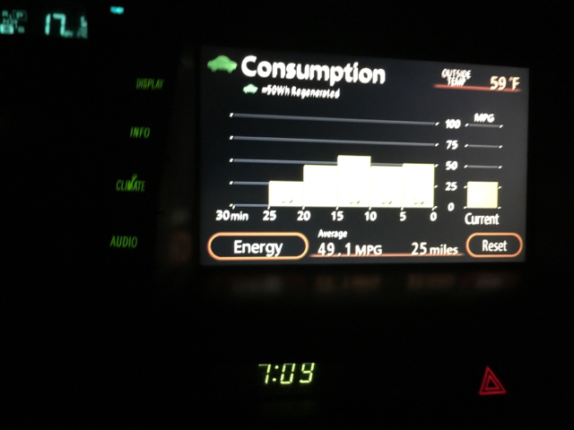

    After 29 min /25 miles of mostly fwy driving my car returned 43.1 mpg while her car was at 49.1 mpg- again same driving style and synchronized accessory use.
    My question is if you think that my car needs new batteries or if you think that the decreased mpg was due to the wider tires and heavier wheel/tire combo.
    I'm obviously going to investigate this further / will drive for a week the car with the old tires vs the new tires and see what's the difference but I just wanted to hear some opinions.
    I would also like to add that her car was clearly pulling away during a "drag racing" that we did with my friend/coworker - I guess that was due to the lighter wheels and tires.

    31 miles of data is not enough to form a conclusion. There are still many variables in play, despite the make and model of the car being the same.
