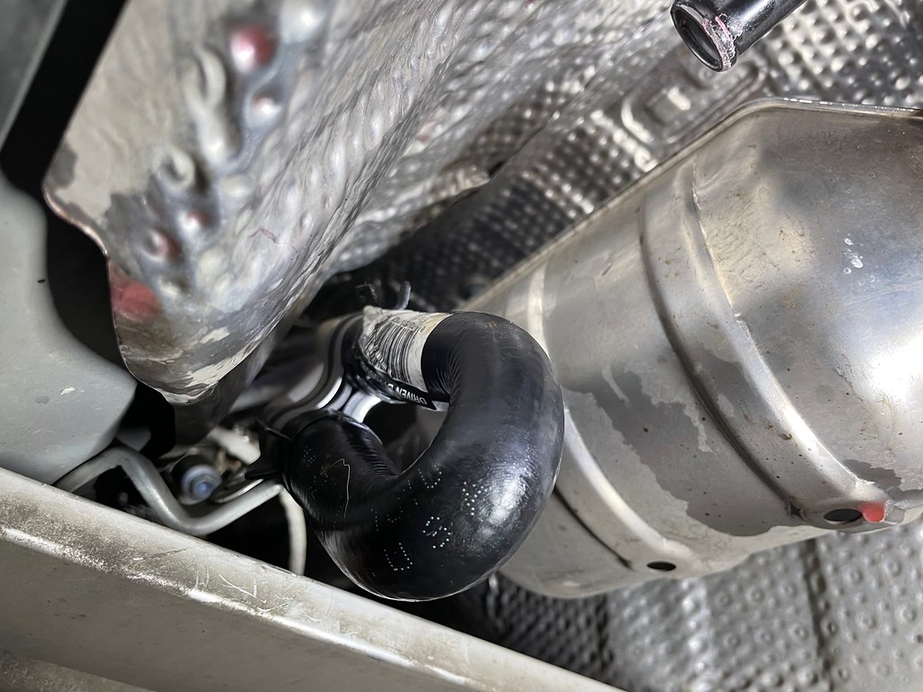

    Texasdiver, all I can say is thank you a million times. My 2016 Prius 3 started smoking on me and I noticed my coolant levels dropping. Took it in to my local mechanic and he diagnosed it as a head gasket. After doing some more reading I learned about the 4th gens having the heat exchanger problem.
    After some more reading I learned that there was a TSB out for this exact problem. I thought to myself how awesome it was that I figured out it wasn’t a head gasket problem while on top of that I was still covered under warranty! I called my nearest Toyota dealership and told them about my problem and how I believe it is the TSB. I took the car in to the service center and the worker told me it would be a 125 dollar diagnosis fee but it should be free if it turns out to be under warranty. I made sure to give him the TSB number and kept mentioning how I believe that is the issue.
    Low and behold to my surprise I got a call from the dealership telling me it was the head gasket and it would cost me 8k to fix…. After learning this I went and picked my car up and felt lost until I found your post on this issue and the DIY bypass!

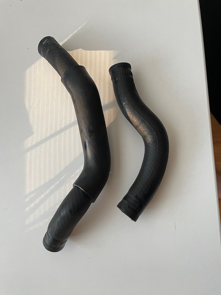

    I ordered the Gates hose that you linked asap and as soon as it got delivered I jacked the car up to by pass it. To my surprise there was dried coolant on my catalytic converter as well as on the 2 rubber hoses that connected to the bypass. While I had the car jacked up I decided to drain the oil and thankfully that looked normal and not milky.
    Sorry for the long story but texasdriver I wanted to make an account and just say thank you! You saved me from getting scammed as well as helping me keep one of my favorite cars I own! Thank you again!!!!

    I've learned there is no need to buy a hose for the DIY bypass - just re-route the hose leading from the heater core to the cat back into the return pipe - done - Much better solution because it eliminates additional failure points going to-from cat - Luck All

    Sorry just logged in and saw this. Exactly, I’ve put 500 miles on it with the bypass and 0 smoke and the coolant level has remained the same.

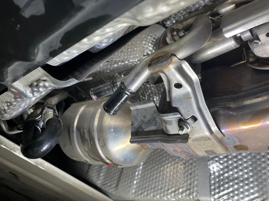

    Thank You for this! I'm going to proactively do this mod when I change my coolant and electric water pump at 150k miles.

    Bekelan 5/8" (16mm) Black High Temperature 3-ply Reinforced Silicone Coolant Cap With Clamp For bypass heater Vacuum Water Port Protective End Cap Kit https://a.co/d/8ZeGXAj

    In Russia, according to general statistics, this problem is common with all-wheel-drive Prius from 2016-2018. Everyone simply loops the hose as described in the post and continues to drive without any issues.
