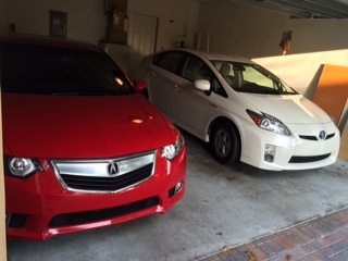

    Camry hybrid power is between a 4 and a 6 cylinder. it has 200 hp. When I tested a Camry hybrid, I felt as if it had more power and faster than my TSX, and TSX is FAST!
    The 2012 Acura TSX has 201 hp.
    This is week 7 for me as Prius driver, almost no driving time for the other car, more "fun to drive" with Prius.
