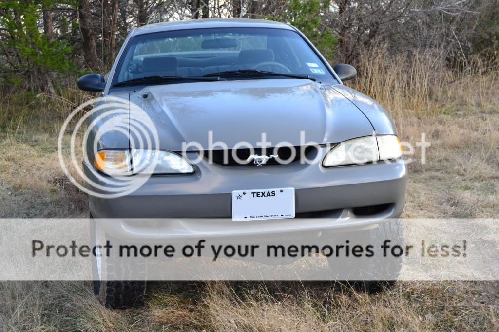

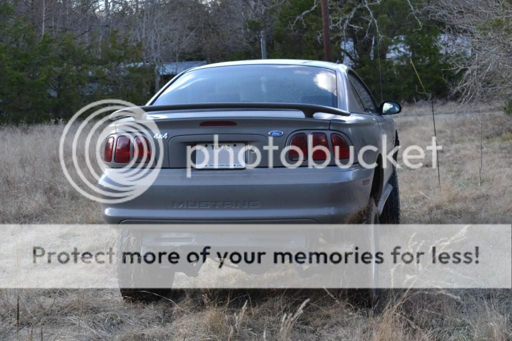

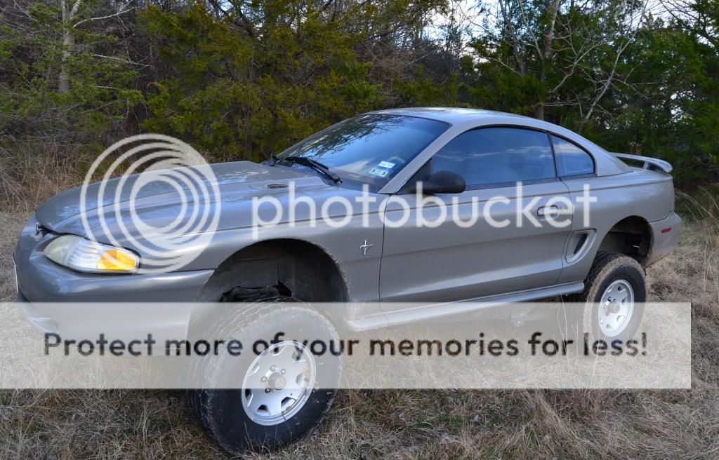

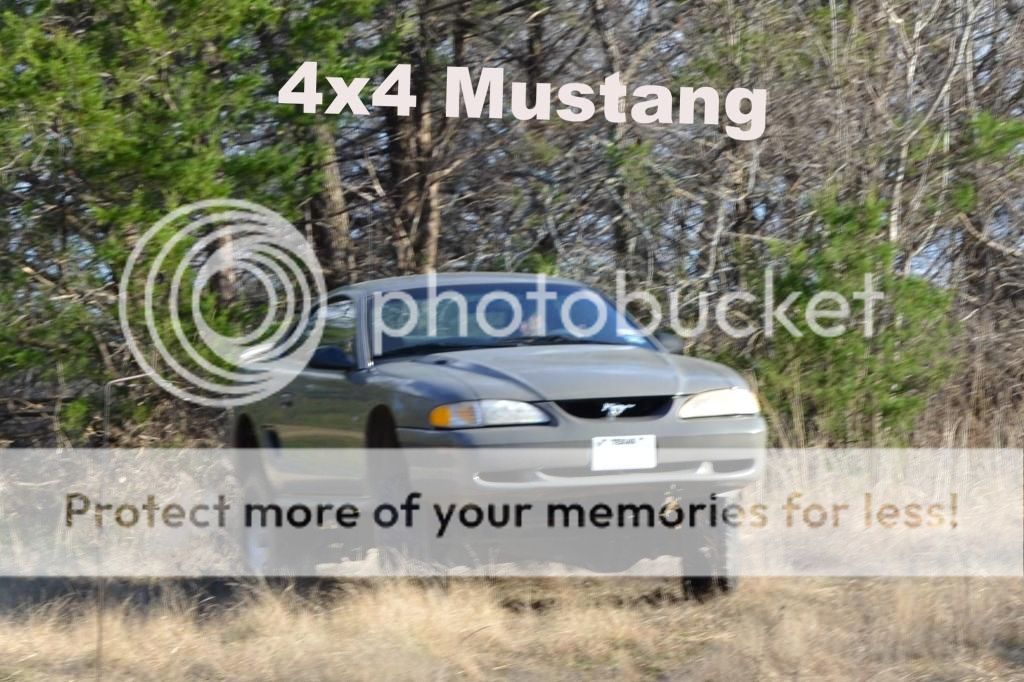

    Hey I wanted to share pictures of the 4x4 Mustang that my dad just completed. Let me know if you have any questions or need advice on what parts you need to start collecting to build your own!

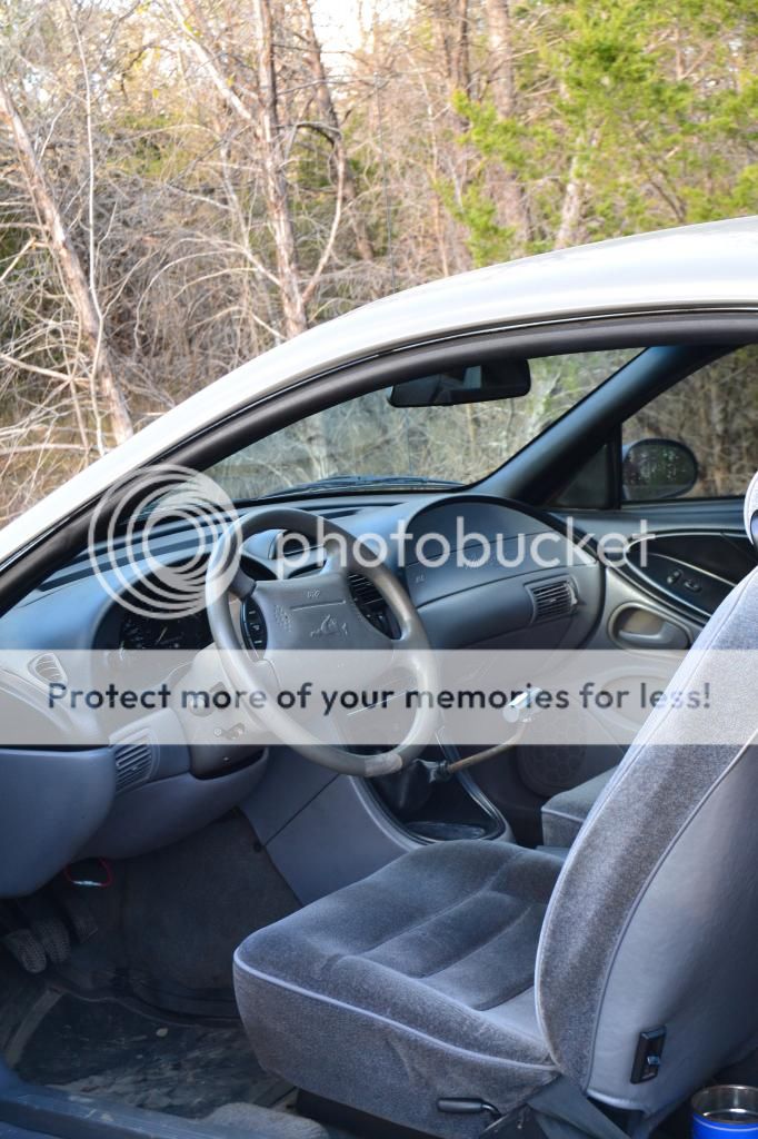

    Spit-can in the rear seat for the kids?
  3. Created_1
    Created_1 New Member
    Feb 15, 2014
    Love your sig ETC, but are you suggesting that 4x4 mustang owners condone or facilitate the use of tobacco products by children?

    OK so what running gear / donor vehicle is sitting under that Stang?
  5. Created_1
    Feb 15, 2014
    It is an explorer sport chassis, Dana 35 TTB front, 8 inch rear, M5ODR1 with a T5 bell housing attached, BW1354 x-fer case, and 3.8 liter v6. AC, heat, cruise, etc everything works and he drives it everywhere.

    I though the jibe was funny, Im sure you noticed the coffee can in the interior picture. The car turns a lot of heads for sure
