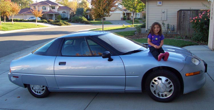

    I can't figure out the reason (or the placement from the pictures) for the single rear wheel. What could it possibly help?
    Yup. four wheels in standard configuration, except distance between the rears was 12" narrower than the distance between the fronts. Definitley using the teardrop shape to max advantage.
    Odd to compare the Cd to a Prius. There are several more aero production cars than the Prius. But none more aero than the EV1 as far as I'm aware. And the EV1 actually existed! In fact I was just lamenting mine as a friend's Mini-e is about to be reposessed... er... returned at the end of the closed-lease.
    RIP EV1. Crushed for my own good.
