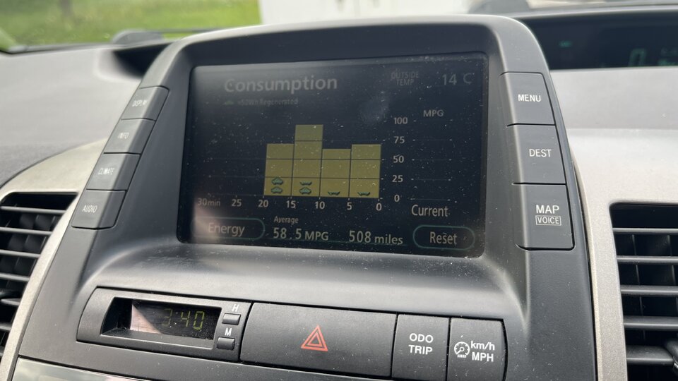

    Managed to get >500 miles out of one tank in my gen 2 for the first time this year, thanks to the increase in temp. The mpg doesn’t reflect it truly though, for some reason.

    how many gallons did you use?

    About 10.5 US gallons.

    the readout has always been optimistic, but that's a bigger discrepancy than usual.
    but often times, you have to average a number of tanks together to get a truer number.
