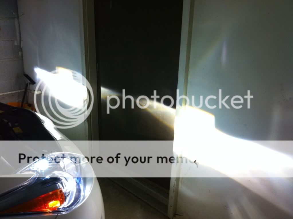

    Access to the original bulbs is hard at first, remove the bolt that holds the air intake tube on passenger side to assist in getting to bulb. From the front of the car or bulb the twist would be 1/3 clockwise, both bulbs. This means the bottom of the passenger side will be twisted to the fender and away from the fender on the driver side. Both plug ends for the new bulb harness and for the existing bulb plug will be on the same side of a silicone disk or cap that really isn't used but molded over the harness. The other plugs go to the Ballast and it's that simple. I had trouble getting the pins/spades in the new harness that mates with the existing bulb plug and had to spread then a little. The red wire on the new harness mates to the purple plug wire on the Prius, or + side if you use a meter. The red must go to the + on the ballast also. I mounted the ballasts on a flat surface close to the firewall and fender. When the lights come on they will buzz for about 15 sec. and then quiet and bright! The white lines on the road pop even at twilight. No one has flashed me yet probably due to the excellent projector lens used on the Prius. This is a major improvement over the complicated shutter used on the 05 we had with HID's. The install is dirt simple just don't over think and match the correct plugs, all get used by the way.

    Here are some DDM 5000K with slim ballasts -

    looks good!
    so you're 100% happy with 5000K?

    I sure am. They look absolutely perfect, not to mention the road is so much more brighter.:rockon:
