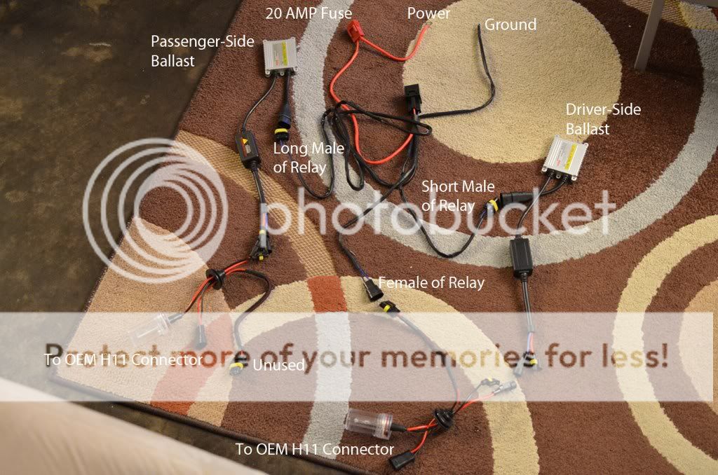

    So I tried installing my HIDextra.com HID's with the Relay but couldn't get it to work since I couldn't figure out what plugs go to what on the harness, so I just connected them directly which worked perfectly fine, but I still want to use the harness for insurance. Found this pic of the harness on an Acura forum and wanted to know it this was the correct way to plug in the wire harness. Please help!

    Thanks for the link. I wired up the harness and HID's the same way as the picture I posted and everything finally worked. Took a couple times though since I had the polarity reversed on the ballasts. If I did the install over again I could probably knock it down in less than half an hour now!

    They're 35watts when they're on, but the reason we put a relay in is because when the ballast first fires up to ignite the bulbs it surges power greater than 35watts that the stock wiring may not be able to handle. The relay is only 11.00 and takes about 10 minutes of extra time to install. It's just a safeguard so that the HID is powered on it's own with it's own fuse.
